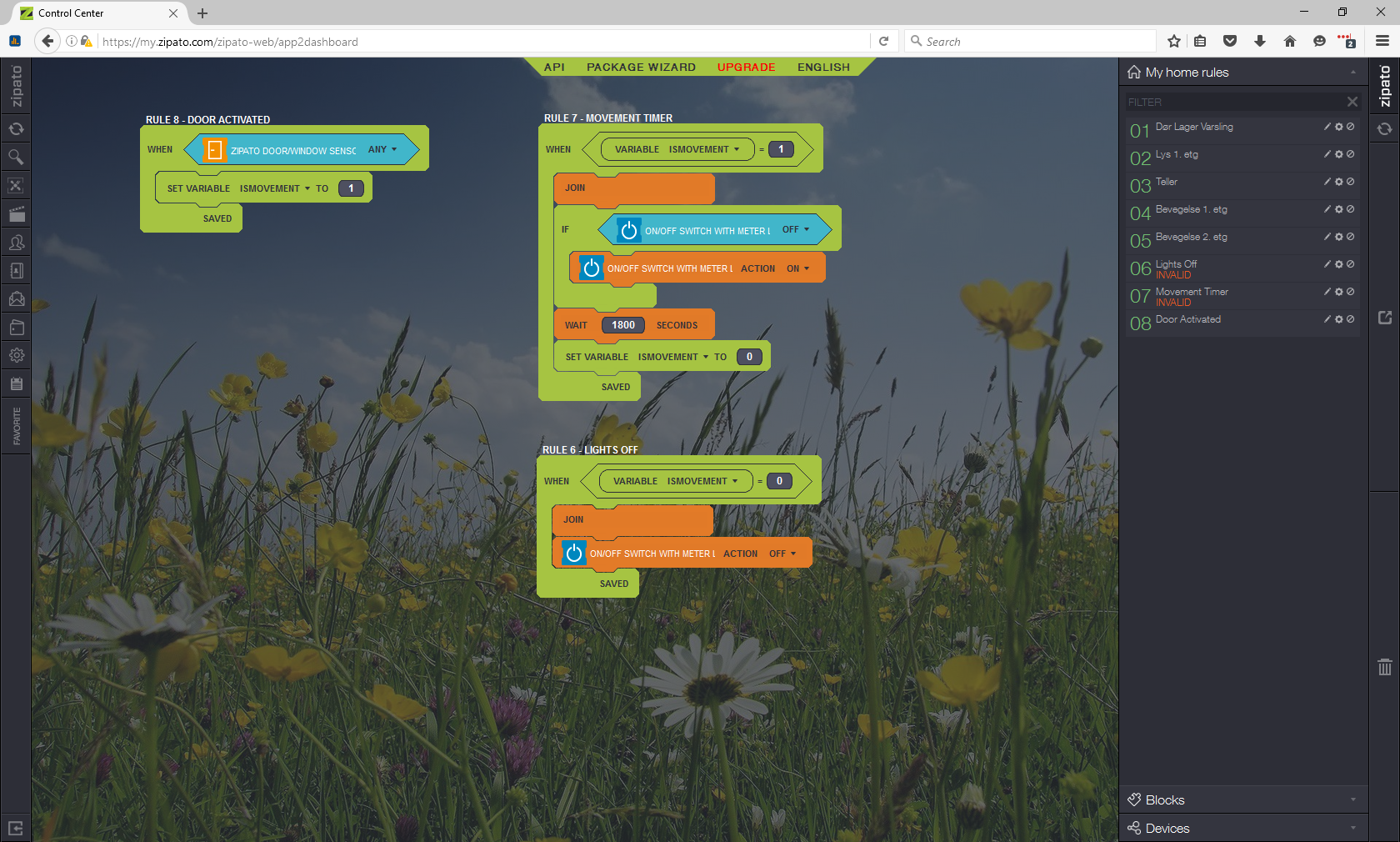

Adrian,
Enclosed is a screen dump showing the rules I'm trying to create. As you can see, the WHEN-rules which test on a variable are rejected by the compiler.
Brgds,
Robert
Adrian,
Brgds,
Robert

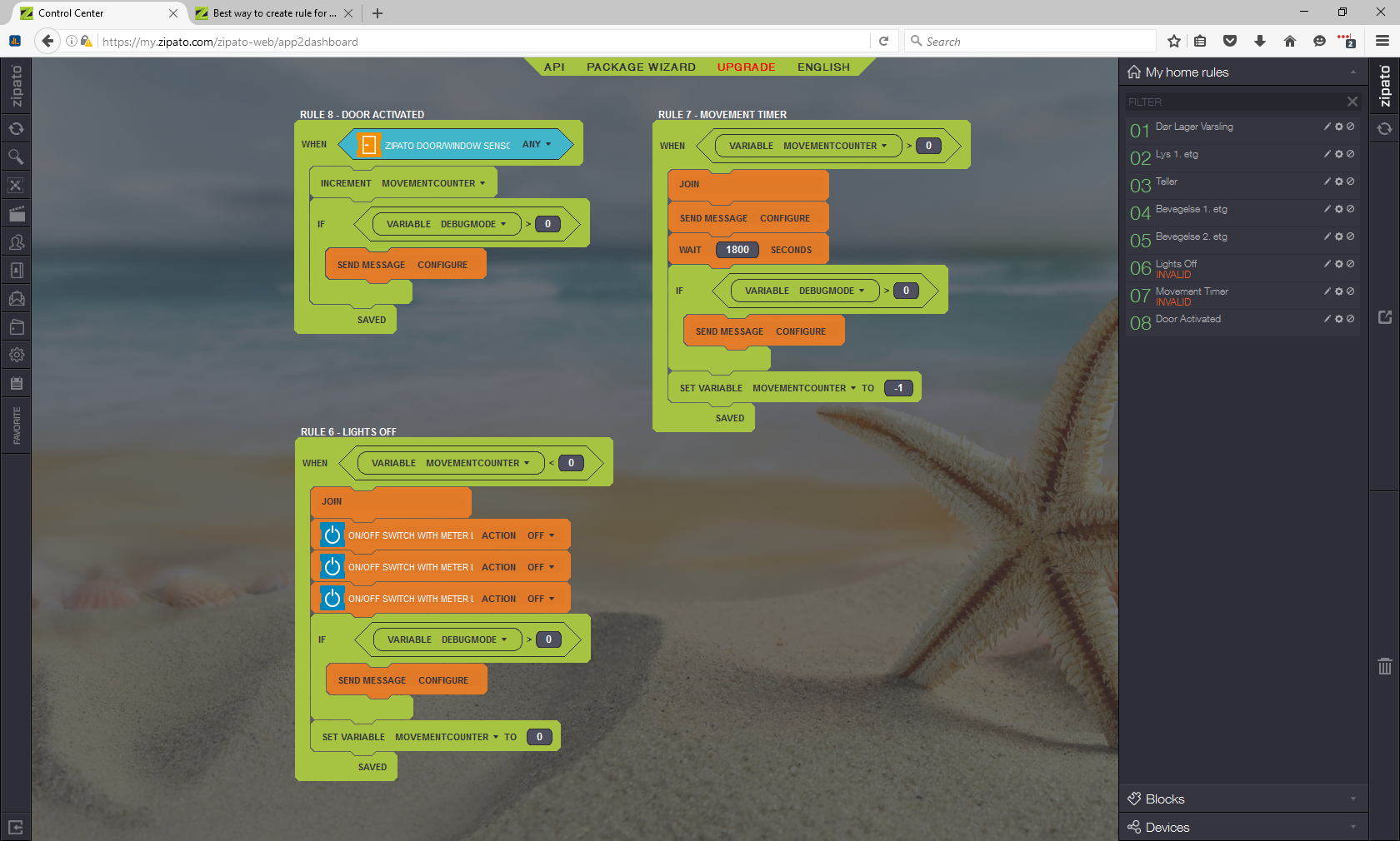

Hi Robert, None of your rules have an event dependency on movement=1, they are all >0.
I can see rule 7 will not work because you are trying to set a variable to -1, try just the number 1. I had this issue, just pick a number.
And another rule 6 is triggered by the variable of less than 0. Variables can not be negative.
What is the debugmode variable?
With everything you have here, the movement variable will never be greater than 0, so no rules will run.

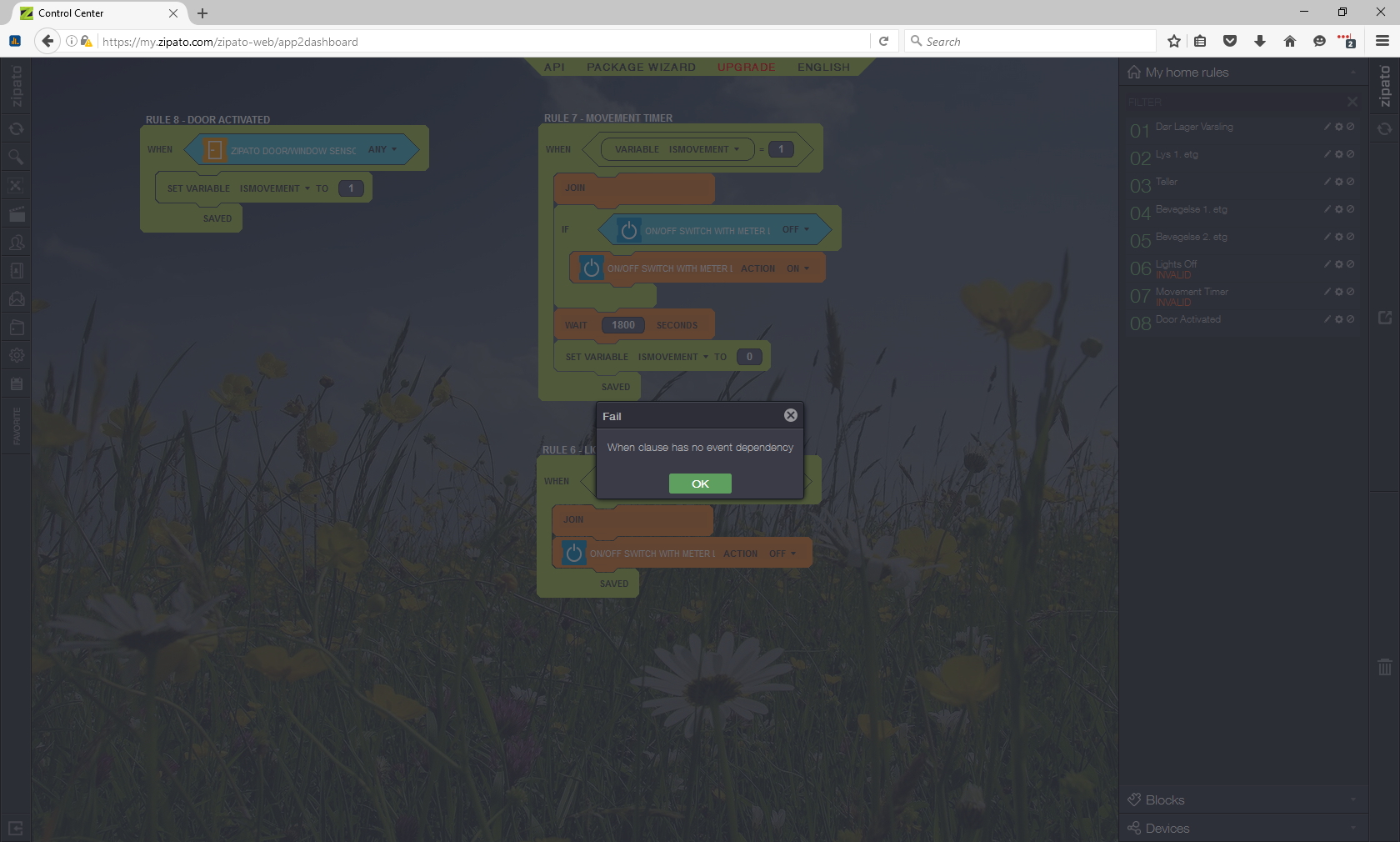

(The DebugMode variable is a setting so I can enable/disable spam messages when developing; I've removed them from the enclosed pic for clearity).
I have cleaned up the example which will not compile and also enclosed the error message.
How did you manage to compile/save/load WHEN blocks which test on a boolean variable ?

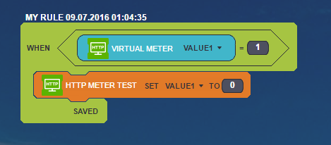

Adrian,
If I have understood things correctly, the virtual devices rely on web services or similar running at Zipato's hosting partner, where an HTTP request is sent from the Zipabox whenever somethings change, and where the web service update the virtual meter.
If this is correct, anything relying on a virtual meter/device will have a slight delay in execution, and will fail completely if the Zipabox is offline...?
