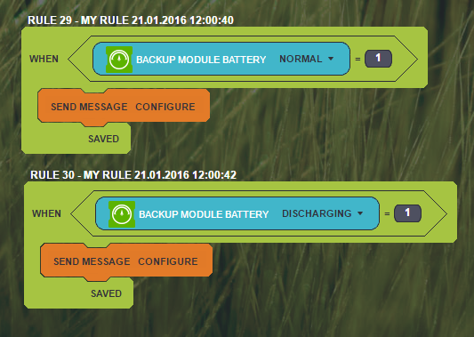

i use the expansion backup power module for the Zipabox, and run a rule when this is activated or resumes charging. The router still runs off a UPS, just not the Zipabox

Adrian,
Thanks for the sample. I'll get a Backup Power Module immediately, and definitely use that to monitor mains power on several places. The solutions we have in place today are a lot more complex and depend on status input from UPSes. While the latter is useful in many places, it's an overkill on others.
