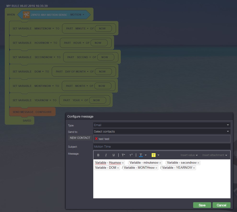

I'm trying to find a way to store Date, Time and SensorIdentifier for last movement, for later use (testing, retrieval)
Programmatically, it would make sense to set a variable to (NOW), inside a WHEN block, but the rule builder does not allow this.
(SensorIdentifier can of course be set, the issue is NOW).
Does anyone have any suggestion as to how I can achieve this?

Dear Robert,
Please have a look at the attached picture. Did you mean on something like this?
Pero Zovkic

Hi Pero,
Thanks. I do mean something like what you describe, only in a single variable instead.
I guess the best is to submit a request to add UnixTime as a separate property to the NOW object :-)

Pero,
I've been trying and testing and testing and trying, but not found any way to store a time or a date value, nor have I found any way to measure elapsed time.
The rule in your initial reply shows how to assemble the values of date and time in a message by having separate variables for each element value, but unfortunately I have yet to find a way to for example store a date or a time in a variable, not as numeric values and also not as strings.
Any tips or tricks would be highly welcomed!
