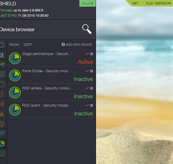

This morning, I saw a bug on website myzipato and android application.
I saw two state for the same zone at the same time.

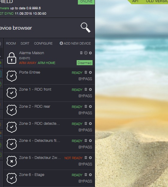

I explain : In perimeter my zone was active but in alarm partition this zone was inactive.

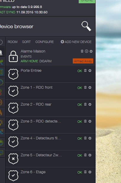

So i activated the "arm away" in first time. Result : no alarm.
One of my condition for tripped alarm is if this state zone must be active.
The perimeter zone still to be active in HMI and and in partition alarm it wasn't.

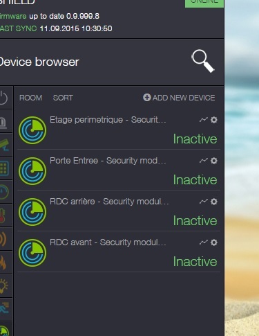

So in second time I deactivate the alarm.
Immediately the perimeter zone had change his state in inactive.
It's bug, no ?
In attach files you could see few captures of my screen.
