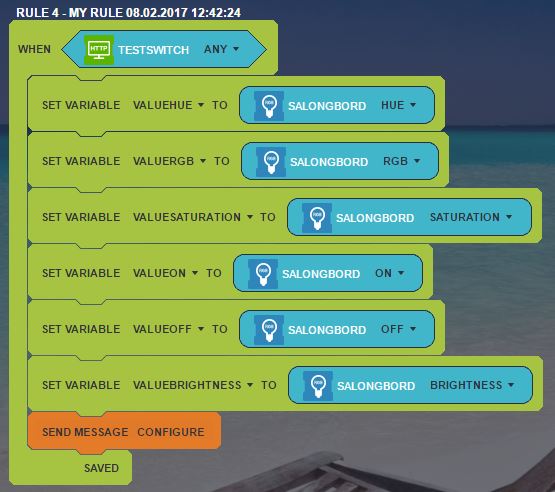

In order to try to read the current values of a Philips Hue RGB lamp; the aim being to set back to the Hue lamp a setting I (i.e. my wife) liked, I created a TestSwitch to read all current values from the Hue lamp, see attached rule.
Each of the values available in the sensor pulldown was assigned to a specific variable, the contents of which was sent as email. The resulting e-mail is as follows:
LV25ZT:
Salongbord: 0.0 ${variables.get("ValueRGB")} 0.0
true true 100
No matter what the lights settings are, the values for Hue and Saturation remain at Zero.
The RGB value is invalid or NIL; the variable doesn't get a value and therefore also never gets initialized and thus also not created (hence the unresolved variable in the mail),
Values for On and Off are True if Brightness > 0, and remain True even if Brightness = 0.
On and Off become False only if the lamps have received an "Off" command.
They remain "false" if Brightness is changed (and lights are on), and need an "On" command to change.
My conclusion is that the implementation of RGB/RGBW is faulty, at least with respect to Hue.
What can be done about this, so that we can read correct values and also set the correct values from/to Hue lamps, directly from Zipastuff?
