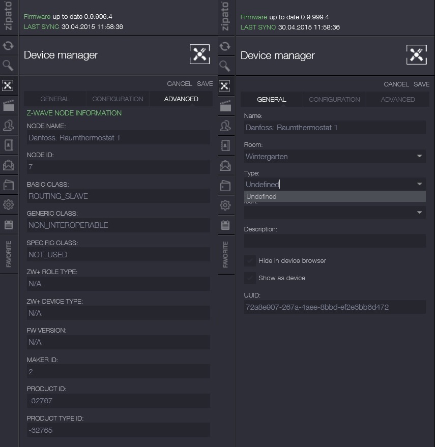

Can u fully implement the Danfoss living connect Room Sensor or the whole Danfoss system?
Christoph Becelewski shared this idea 11 years ago
Can u fully implement the Danfoss living connect System compnents, that mean not only the radiator valve!! For older People like my parents - especially my mom ;) - it`s essential to use a real device like the Danfoss RS room sensor for adjusting the temperature.

I couldn`t find a newer code for this device but I have inclused the room sensor, but the classes were wrong (non_interoperable), so it seams the device or the classes aren`t implemented in the Zipato products
Replies (7)
Greetings,
What feature do you think is missing from our current support for this device?
1 Christoph Becelewski ● 15 minutes ago I cant bind the room sensor with radiator valve, I can`t use the room sensor for add as climate device or something else.
in the Picture you see that nothing of the classes are right or installed, why?
what`s wrong?
The only Thing I could, was binding the secure SRT321 with the danfoss room sensors ... but that wasn`t that what I wanted ..
This particular unit you have is only meant to be used with Danfoss controllers, it is not meant to be used with other Z-Wave controllers. That's why it wasn't recognised correctly by your Zipabox and that is why you can't use it as intended.
Check the screenshot you provided and you will notice that the GENERIC_CLASS of your unit is NON_INTEROPERABLE.
Then check the PepperOne DB entry for this device:
http://www.pepper1.net/zwavedb/device/565
Please note that the generic class should be MULTILEVEL_SENSOR, not NON_INTEROPERABLE.
I suggest you return the unit and ask for a variant that is meant to be used with all Z-Wave controllers.
what`s wrong?

I guess I´ve locate the problem. Thanks to Marko and the other ....
I think the trick is the version of the room sensor the last two manufacture versions are 014G0159 (Devolo branded) and 014G0160 from Danfoss. These room sensors seems to be compatible with all z-wave standard gateways, my room sensors are version 014G0158 from Danfoss,
what seems to be not compatible with the z-wave standard also not compatible with the zipabox .. **grmlz*
now it is too late for return .. the time to return is over ... Thanks for helping @ all
People, please read the manual it is a scene controller.
