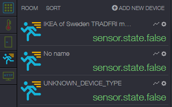

but when I check the sensor in the device browser, it always gives the following state:
sensor.state.false
the state doesn't change even when the device's LED indecates that a motion is detected
moreover, the sensor is not included in the devices in the rule creator
