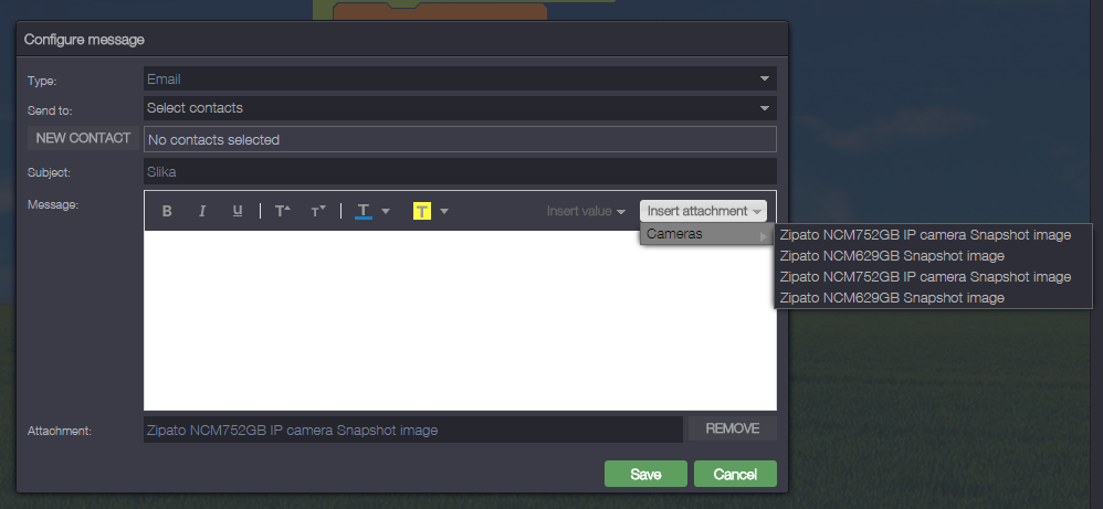

Dear Eyal,
Yes of course, it is very easy you just have to insert action block "Send Message" and under Configure>Insert attachment> choice from which camera you want to send the image.
Dear Eyal,

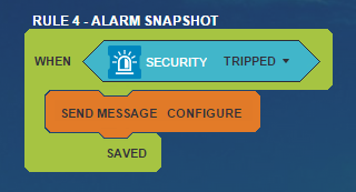

Any way.. I've added the Rule:
The 'Deurbeller' is a virtual switch for testing purposes.
When i flip the 'deurbeller' switch, i receive in email, however without my snapshot in it. I've configured the 'Send Message' as follows (notice the attachment)
Since the snapshot is absent, i figured it might be a problem with the 'snapshot' url in the camera. However, if i put that url in a browser, i get a snapshot.
Any idea's on what i am doing wrong?
(the camera files manager remains empty)

Hi nickyb2,
Do you see snapshot in your snapshot list under "Device Manager->Cameras", File manager icon?
If you changed FTP setting then just removing->Re-sync->Add camera will create new FTP folder and then you can test the rule to take snapshot, basically check if snapshot gets on ftp server by checking list of snapshot images under cameras in device menu. And then return to this puzzle with send message to test this rule again.

Ola,
Nope. The file manager remains empty of snapshots.
I've now taken the following steps.
A few things i have now noticed. Nothing works, except the local mpeg feed. However, after a few minutes the remote feed started to work and the snapshot also started to work.
more.. the device manager camera icon never showed my an image, it does so now.
When i click the little camera icon to take a snapshot, my file manager shows the snapshot.
Step 4: i've updated my rule to include the new camera.
Step 5: sync my rules.
Step 6: i've received an email with a snapshot.
So.. hurray, it works.
Thanks you very much for your time and help.
