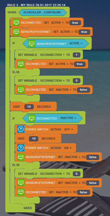

Hi. I invent rule for checking internet connection. But is have some trouble with this script. I know that virtual devices works only if internet connection is available. In this case use virtual device and variable. I try to change status of virtual sensor if status changed I also change variable. If status of virtual sensor is not changed I also change variable. Than I check if variable means connected than drop status of variable to "not connected". Another case I restart modem via smart switcher. In this script I use additional virtual sensor because i want to see variable value. But I see strange situation. In first part of rule I set virtual sensors in "Active" status. But only one changed. Do Rule creator have limit for update virtual sensor? Why I can't change status of it?
Ok. Firstly I dont see a reason to set the two switches to active right after the when block. These are set in the if else puzzles anyway. Try to remove them + insert a Join instead (after the when puzzle and before the 1st if).
Also after the wait puzzle you must use a refresh puzzle as the state needs to be actual not the one before the wait puzzle (otherwise zipato will use the states that was actual at the trigger of the rule (at the time you have set).
Hmmm, looking into the rule it does not make sense to me - without any modification that I have described above, although my modification request still might make this rule a bit strange.
Your rule will always set both switched to active so they will always have the same state when the first if is executed. Are any of these sensors and switches linked to something external that can also change the state?
I know that virtual devices works only if internet connection is available. If I haven't connection to the internet in my view virtual devices will have previous state (Inactive). But when rules run, only one virtual device changed status. Also I don't know what is the differers between set state commend of virtual device and sent http request with change state.

I have only one zipabox and two devices. There are smart switcher 6 and Figaro eye (multi-sensor with temperature sensor). So I try to check internet connectivity via virtual device and variable. I just want drop value value and check value of virtual sensor. If connection is available virtual device will change value of variable and itself and I can check it. It's simple rule but i see that it's not working like in common program languages. I will try to debug rules for understanding how it works.

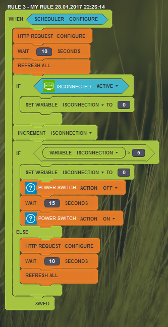

Hi, Thank you all for advices. I found the solution. In attachment you can find my rule. I use virtual sensor and variable for checking internet connection. Also I add counter for excluding random restart of my modem. I use 1 minute scheduler and check variable. If i see that last 5 minutes virtual sensor is not updated that means internet connection is absent. Also I think this rule can bee used if you need to send some command to the modem / controller which helps to restart internet connection. But in my case I use smart switcher 6. This issue can be closed.

1) Yes, it works fine. If the internet cable is unplugged during 5 min I get restart.
2)It' just change state in On stage or Off. In first http block I set it in On position by https://my.zipato.com/zipato-web/remoting/attribute/set?serial=011C55200D0186C5&apiKey=710fbc79-b49f-44b6-9fde-de9a0bddcd8f&ep=1b66ae0d-6a5e-4136-8a9e-64d9dc7f16c5&state=1
And the second one https://my.zipato.com/zipato-web/remoting/attribute/set?serial=011C55200D0186C5&apiKey=710fbc79-b49f-44b6-9fde-de9a0bddcd8f&ep=1b66ae0d-6a5e-4136-8a9e-64d9dc7f16c5&state=0
Also I found not standard behaviour( for standard program languages) of checking virtual sensor state, If we have connection with the internet we can use control block (if else) for checking virtual sensor state. But if we don't have connection with the Internet that means all control blocks will not work. I understood that when try to check if virtual sensor has inactive state when internet cable is unplugged
unplugged.
unplugged.

Thank you. If you select scheduler based on virtual devices you must be sure that you have internet connection at first. Although if you have connection to the internet it's not guarantee that virtual device will change value successfully. In my rule i see that sometimes state is not changed in this case i have to use increment block for variable. I recommended do not use virtual devices for critical for you blocks because it works not so stable.
