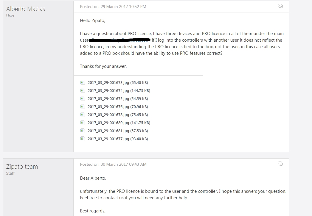

Thanks for your thoughts. Just to avoid confusion; I believe you are incorrect with regards to the Pro licensing scheme: The license is tied to a controller, not a person. The "skills" and "features" enabled in the Pro license applies to rules creation, protocols etc. These abilities do not change if another person logs on to the controller. Persons, on the other hand, are given different "rights" (contact, tenant etc) although this rights-system is far from ready for the market.
Not according to Zipato Support and the functionality I have right now. I have two users for myself (for testing purposes) and the wife's. If I log to any box using any other user than the master (in which I have PRO) I cannot use all puzzles, add devices from all protocols, etc.
See screenshot from Zipato support.
It makes sense to have only one "master/owner/administrator" per Zipato-controller, and to tie *all* rights to this user, but IMO, the Master should be able to grant "full Rule & Device Edit" to another user. Other registered users, though (including my wife and kids) should NEVER EVER get the possibility to mess around with settings, devices or anthing else. Unfortunately, this schema is FAR from completed.
I think the rights are totally separate than licences, and I agree with you that the right scheme is far from completed. But as you can see on Zipato explanation of PRO below, PRO licence was advertised to be required per controller, no per controller/user. That is why I contacted Zipato support, I thought it was an issue with the provisioning system but you already saw their answer.
