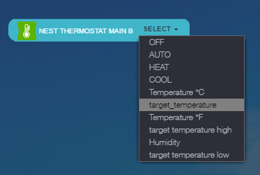

That's not true. I have a Tado thermostat (which is my master thermostat, connected to the boiler), and two Nest thermostats in the bedrooms. I control the set points of all the thermostats via rules in the Zipabox. I do this when there is a reason to deviate from the standard schedule programmed into the thermostats - for example: it's a weekday but I'm at home because it's a public holiday; or it's a weekend but I'm out of the house, etc.
To be honest I don't know anything about virtual thermostats in the Zipabox - I have no idea what they are for. I have the Nest thermostat devices added and control them directly. The Tado is controlled via HTTP requests.

When I say that I control the Nests directly, I refer to the devices with the thermometer symbols. See screenshots.
