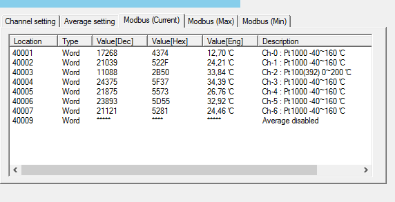

I'm using the Advantech ADAM 6000-series TCP IP modules.
As a start, I would like to see the implementation of the ADAM 6015 module (7 temp senors)
See attached documentation for the total series but for now I would only like to read the actual values from the ADAM 6015's 7 registers :
Address (4X) Channel Description Attribute
40001 0AI ValueRead
40002 1AI ValueRead
40003 2AI ValueRead
40004 3AI ValueRead
40005 4AI ValueRead
40006 5AI ValueRead
40007 6AI ValueRead
I think the registers are read out in 16 bit value but I could do decoding with some operators as long as the value is between 0-65535....
Is this possible?

I think it is possible. I might even do it tomorrow. If not, then by mid next week. As you know, probably the problem might be to properly format the read value, if it is not stated in the documentation (haven't checked yet)-

Regarding formatting, the 16-bit value in the read register represents a temperature according to the attached type of sensor. The module it self does just reports a value in the range of 0-FFFF (hex) . I don't think it a good idea to build into the device driver (at least not to start with) formatting according to a specific senor (like PT100, PT1000 etc). For me, it's good enough to receive/display the decimal number as an integer. Please see attached picture showing how it is related in the Advantech user application for controlling the ADAM devices. Note that the senor at address 40003 is a PT100 where the representation goes between 0-200 degrees while all others are PT1000 senors with the range -40 to +160 degrees. The value for address 40003 is lower for roughly the same temperatur.
