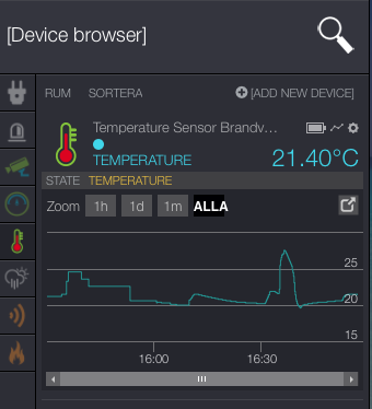

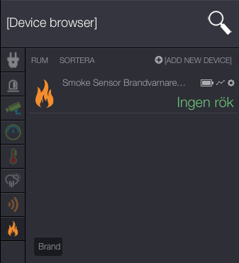

The only thing i get to work is the temperature, i don't get a signal back from the smoke alarm or the temperature alarm.

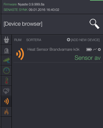

The heat sensor reports back "Sensor off"
The smoke alarm reports back "No smoke"
The temperature works fine.

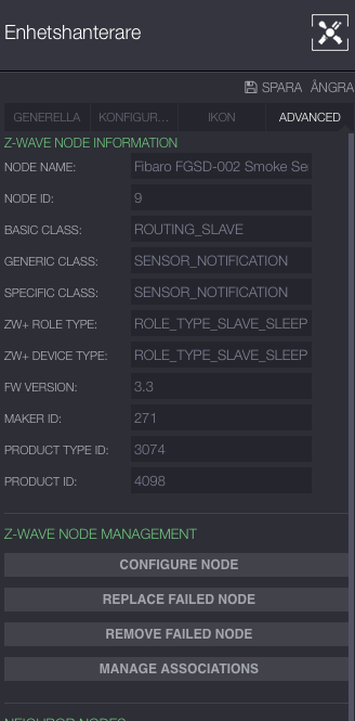

The smoke sensor is produced 3rd of december 2015 and runs firmware 3.3

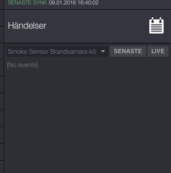

Can you see that it has been triggered when you look at events for that unit?

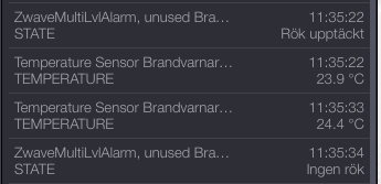

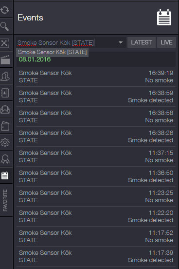

I have tried it again and i get a response back from the smoke alarm.
First "smoke detected" and then a couple of seconds later "no smoke".
Why doesn't it update that in the device browser? And why does it say that "smoke alarm heat sensor is off?

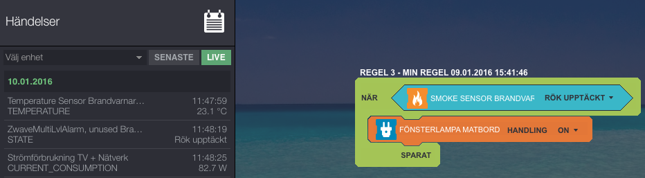

My events doesn't get triggered as it doesn't react to the "smoke detected" signal from the smoke alarm. Ive made a simple rule to turn on one of my lamps if the smoke alarm goes to state "smoke detected". But the lamp doesn't get turned on. See attached file.

I have just bought 4 FGSD-002 with FW 3.3

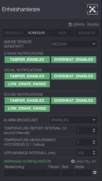

For me did it take a while before the alarm in the sensor set off. This is ok in a kitchen, but in a sleeping room or the laundry do I want the alarm to be more sensitive. Do any one know if this is possible to change the sensitivity of the sensor?
I do also want to want to know how I shall comply an alarm rule that will be triggered if the sensor reach a certain temperature. As I understand it do the sensor have a default value when the alarm shall be triggered in the unit itself. I do also want to be able to change this value myself, but how?

Can you see that the sensor changes state in the webui when detecting smoke?
