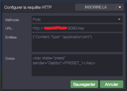

Wanted to share how I can control my BOSE Soundtouch with my Zipabox via Virtual switch and rule.
So far this is a very simple control: Play the playlist which is configured on button 1 of Sountouch. Refer to BOSE Soundtouch API documentation (available here: http://products.bose.com/api-developer/index.html ) in case you need to customize your own rule.

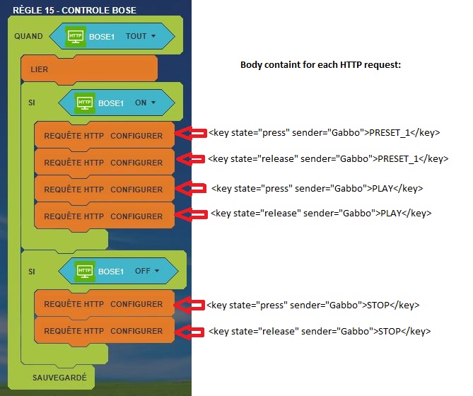

Idea is to use Virtual switch and a rule which will monitor the status of the virtual switch:
when ON, it will send HTTP POST request to BOSE Soundtouch in order to emulate key press on the BOSE Sountouch: Press Preset 1 touch and then play
When Off, it will press the Stop button.
Note that the BOSE API, includes both press and release action for each button, explaining why I have 2 HTTP request for each actions (one for "press" and one for "release")
The URL to reach soundtouch is http://Local_IP_ADDRESS_of_BOSE_Sountouch:8090/key

Can I ask why you are sending a http request for both press and release? Doesnt the Bose just need press or release?
