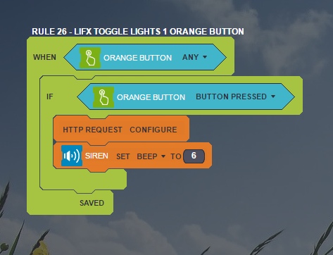

5: Now create a new rule using a button like the example shown here. (The beep is only there to have a audible feedback.)

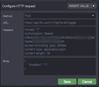

6: To configure the HTTP puzzle part use "POST" and copy/paste the
  1. Request Headers field
  2. URL field
  3. Request Data field
7: Save your rule, sync and see the magic working!
