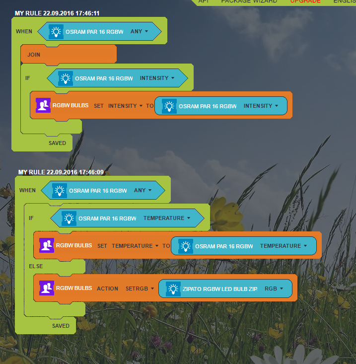

hi guys, ive been doing this for the Osram lightify bulbs. Milan has recently added a warm/cool white feature to help sync the white value, which you could not do before. I could only sync the RGB as it returned a value, the whites did not. I just have not had the chance to test this but it should work.
Basically I just allow one bulb to be seen in the app. then have a rule that starts on any change, if rgb then set rgb value of the "group" (i created a group of all rgbw bulbs) rgb bulbs, to the value of the bulb that changes (the one seen and used in the app). Same goes for dimming and now white (hopefully).
Something like attached
