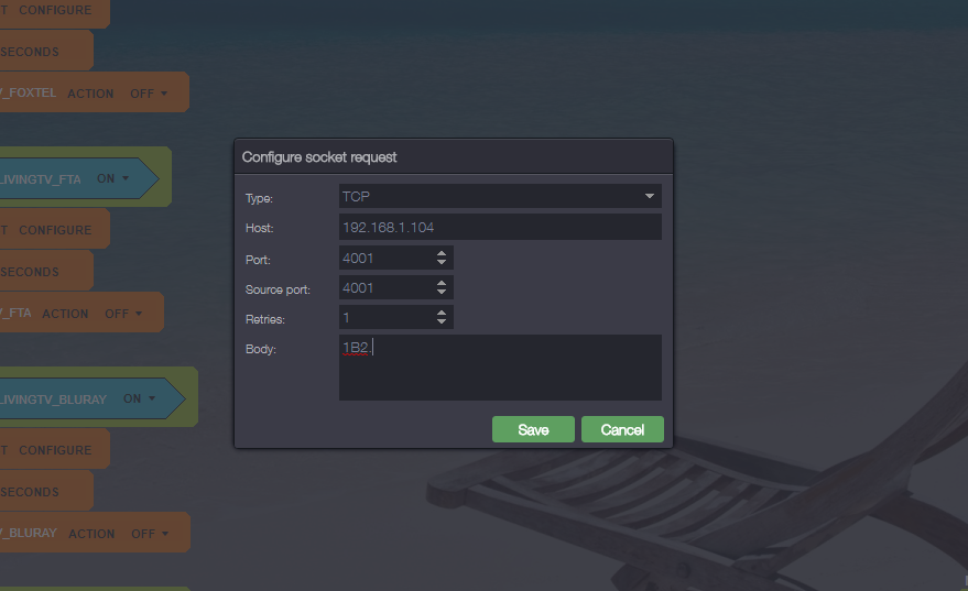

hi paul, did you try issuing the commands for the Epson over http request puzzle or socket request puzzle.
We recently added a avgear hdmi matrix that we controlled via tcp/ip with the socket request puzzle. It works fine. See attached eg of a rule.
