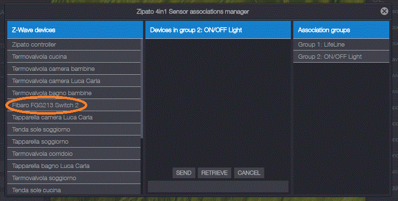

I'm trying to associate a Zipato door/window sensor to a Fibaro single switch 2 (FGS213) to automatically turn on the light when I open the door.
I select device manager --> Zipato door/window sensor --> Settings --> Advanced --> Manage associations

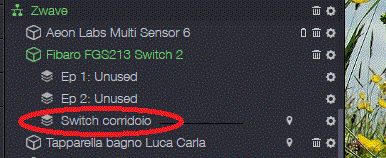

In the first column, the only device available for association is the first level of the Fibaro group (Fibaro FGS213 Switch 2), but the automation does not work this way. The device that switches the light on, and that I should choose in the associations page, is the child of the first level (Switch corridoio).
Also in my rules it work this way. "Switch corridoio" is the sensor to be used to turn on lights.
Is there anyway to associate the right device (Switch corridoio), or maybe to "tell" to the first level (Fibaro FGS213 Switch 2) to switch the light on?

Have you actually tried to complete the assotiation by dragging the fibaro switch to the middle (whilst selected group 2) and the hit send? Then hit retrieve, does the fibaro come up? On your printscreen the middle part of the window is empty.

Attila, my problem is that I can't choose the right device in the first column.
The 1st level comes up in 1st column (fibaro fgs 213 switch 2 in my printscreen), but I should choose its child (switch corridoio in my printscreen).

Greetings,
The association manager does not support multi channel association at the moment. That's why you can't select individual endpoints.
