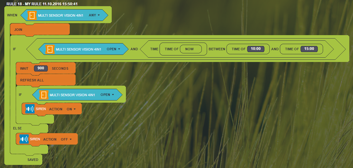

Try this one, and feel free to ask if you have any questions.
You obviously need to change the sensors and alarm with your devices.

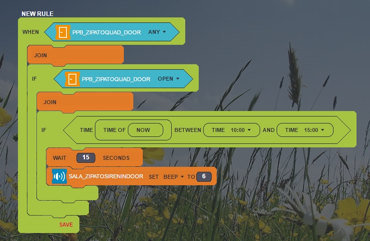

With the example I provide (similar to Marijan) you will be able to get a notification if you OPEN the door between this time frame and left it open for more than 15 seconds. My rule and the other example won't work if you open this door one minute before 10:00 and leave the door open for whatever time. If you need this functionality too, another (more complex) aproach needs to be taken, let me know if you need this and I can provide an example of how I think you could solve this.

Marius, the solution I posted accounts for your last thought - hence the JOIN command.
And the ELSE clause triggers on ANY changes on the door controller, so as soon as you close the door, the ELSE clause triggers, and the timer/siren stops.

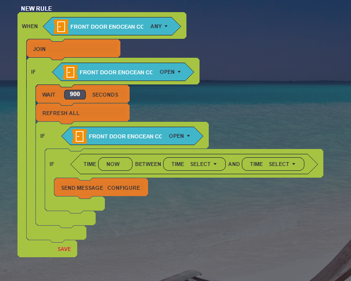

try this, let me know if it works for you
