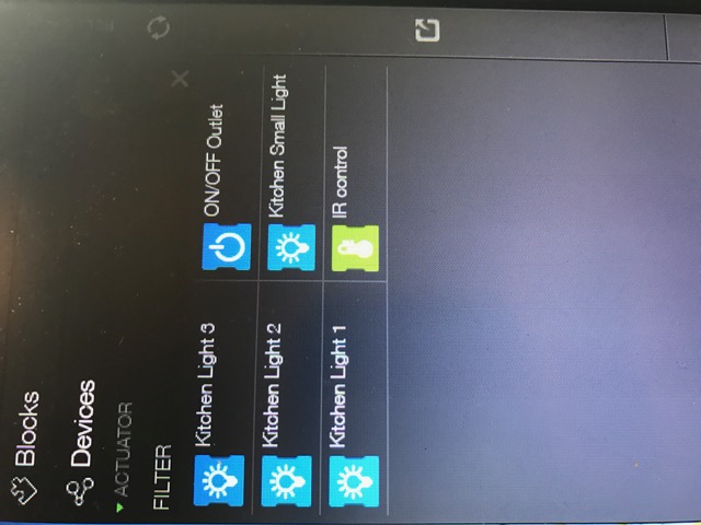

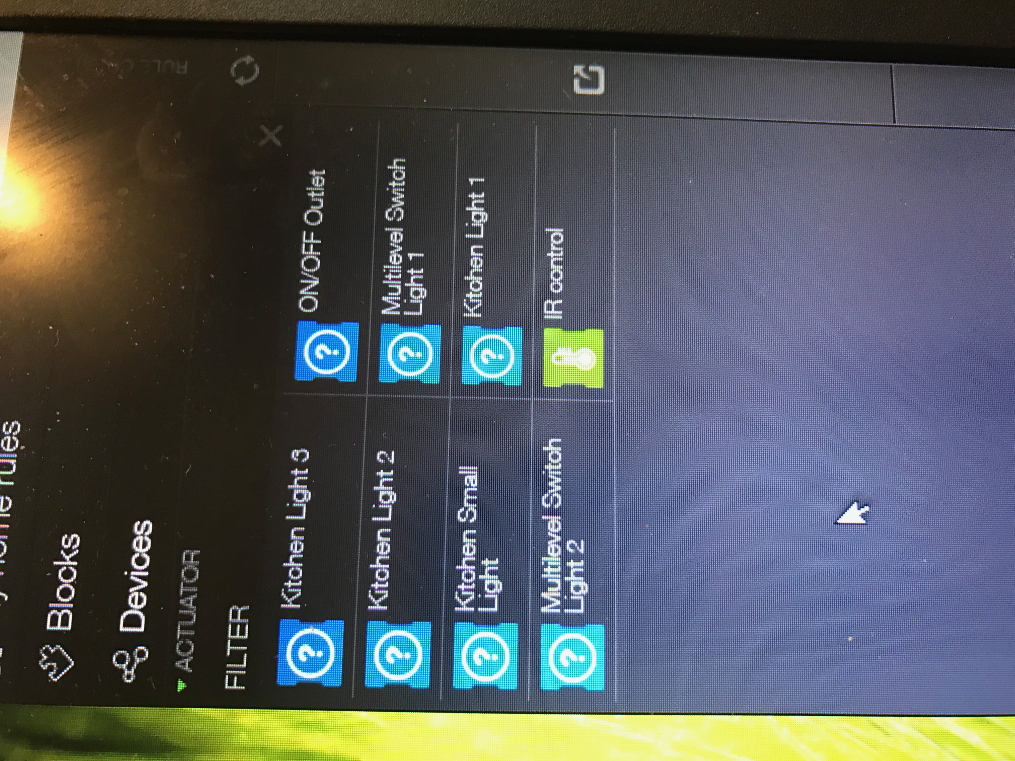

I'm having same problem with Z-wave devices. As soon as I add new device I loose all setting on devices that was entered before. Im going crazy, I tried everything . Customer support was no help. I tried PC, Mac and Iphone same result,
I just dont know what to do. This is a short video how device gets to generic settings as soon as new device is added. Will Zipato do anything about it ?
I guess they dont allow video, here still pictures before and after I add new device
