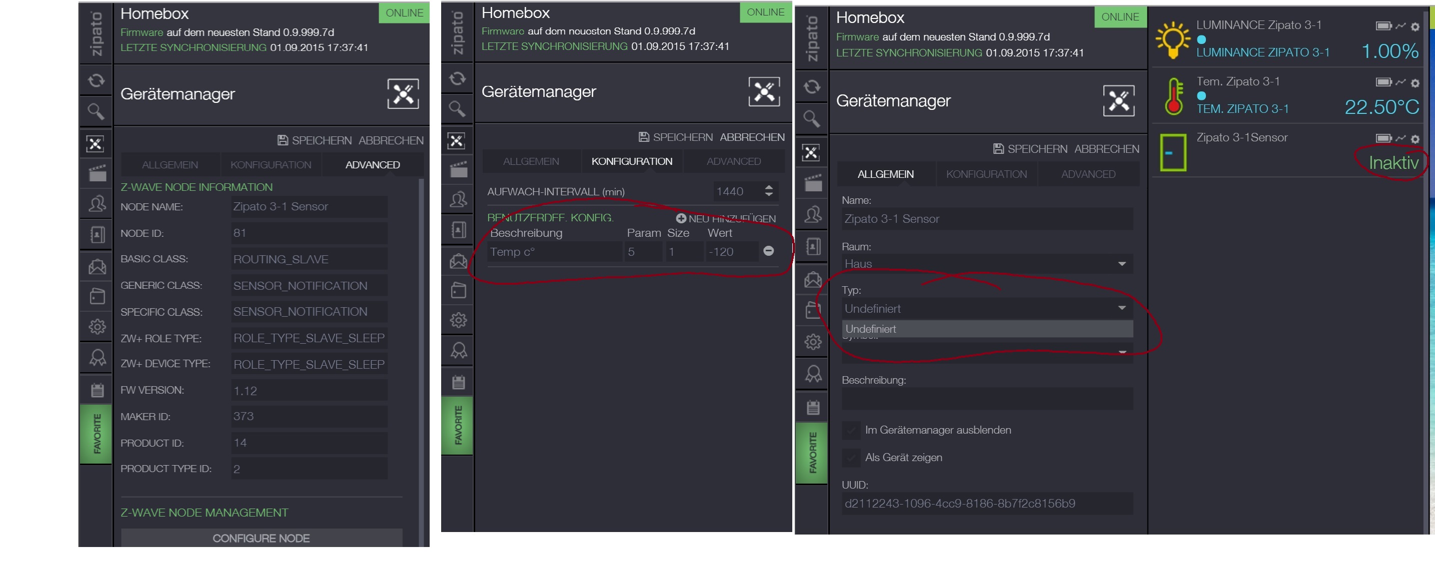

I have the Devolo Door/Window Sensor and it works, but not 100%.
All 3 functions are given (movement, temperature, brightness).
The display open / closed is displayed as active / inactive.
The temperature is displayed in F. I could adjust via parameters.
Because no changes are possible.
This is only an information.
Greetings Maik
I think the right Parameter for C is Parameter 5, Size 1, Value 8
Hello
Work with the parameters I've set with the temperature display in ° C.
Did you have any idea how I can change the status from "activ / inactive" to "open / closed?
regards Maik
Hello
regards Maik
