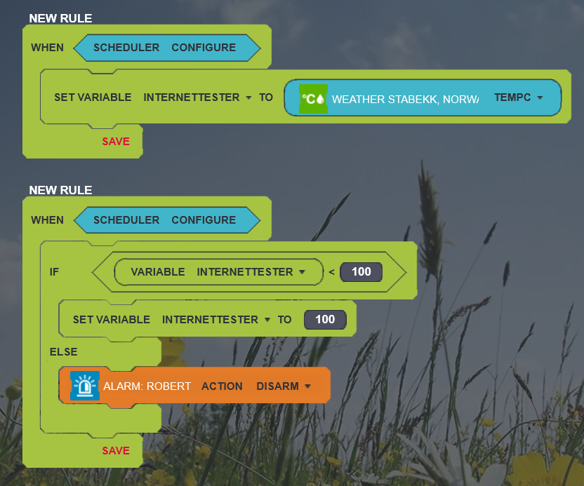

You can leverage on the fact that rules which depend on Virtual Weather Station data actually stop execution until data is available. The following should work:
Create a rule which starts Every Minute using a scheduler, in which you for example get Virtual Weather Station attribute TempC and store this value in a variable InternetTemperatureChecker.
Next, create another rule which runs every TWO minutes. Here, you'll need an IF which checks if the content of variable InternetTemperatureChecker is < 100. If it is, set the value to 100 (so that the other scheduled rule can set it to the correct temperature again when it runs). Inside the ELSE you can do whatever you need done when internet is down.
