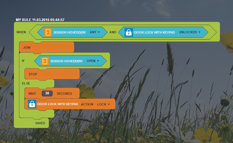

Just got this system and want to make my first more advanced Rule and want to ask how you would make it.
Items i use in this rule:
Zwave doorlock (danalock V2)
Zwave door sensor.
I want this to work.
1. when doorlock is unlocked AND door is closed then wait for XX sec then Lock Door (simple Rule)
2. BUT if door opens within the XX sec then doorlock should stay unlocked until door is closed again
and then restart xx sec and lock door.

Hi Allan, the fuction JOIN is there to be used. Simply make the rule you just wrote and put a join before the execution. Join will stop the execution if the state has changed. IE:
when when doorlock is unlocked AND door is closed
join
wait xx sec
lock the door

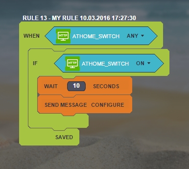

Attila,
You got me curious about this whole thing with the JOIN block so I made some tests, it looks like you
were correct. I think the description in the knowledge base is not accurate. I made a rule with two
different variations, one of course without the JOIN block and the second with the JOIN block. Rule consists on sending a push notification when the switch is ON.
My methodology for the test was the following; I created the rule under the scenario 1 (without JOIN), I turned ON the virtual switch and waited until the status in the app refreshed and showed is ON (usually 2 or 3 seconds) then waited one second more and turned OFF the virtual switch, this well under 5 seconds. When the 10 seconds elapsed I still got the message even though the virtual switch was OFF for about 5 seconds (even the status on the app showed OFF).
Scenario 1 (rule without JOIN)
WHEN virtual switch is ANY
IF virtual switch is ON
WAIT 10 secs
SEND MESSAGE

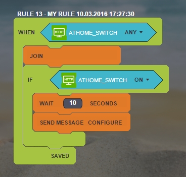

After that I tested with scenario 2 (with a JOIN instruction) and I did the same. I never got a push notification.
Scenario 2 (rule with JOIN)
JOIN
WAIT 10 seconds
SEND MESSAGE

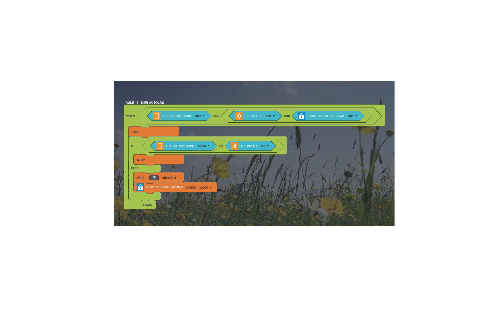

So finally got this to work an advanced lock rule.
1. if the door is unlocked and the door still are closed then the lock will close after xx sec.
2. if the door is unlock and an input is activated then the rule is "paused" until the input is deactivated, and the lock is locked again after xx sec
3. if the door is unlock and door is open the the rule is "paused" until door is closed. and lock is locked again after xx sec
this is a very cool rule engine ZIPATO got!
