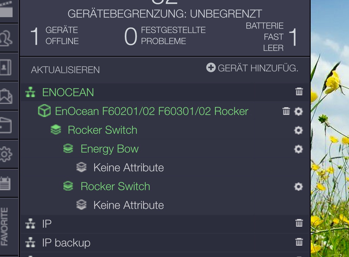

I want to replace my switches with wireless versions. The best fitting switches for my switch bars are the Eltako enocean switches.
But when I include the switches with "auto detect" and der EEP F06-02 0x the device has no attribute. See picture below.
Do you have any idea?

got an answer from the Support:
  1. All Enocean profiles you have tried are not suitable for this device. This device needs new custom descriptor which takes time and at the moment developers have other devices/projects with higher priority. At the moment I am not able to tell you when will this device be supported, please be patient I will contact you when we will have more information about this device.
Has anyone an idea to replace normal switches in a switch bar??
