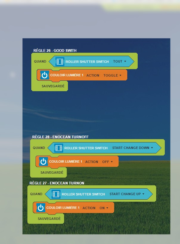

Hi have 2 swith roller shutter EnOcean viamar
when I create a rule to "Any"
the rule is executed.
but
when I precise "change start up" or "change start down" my rule does not execute.
So I do not know how or precisely alumer put out my lamp ..
The lamp will be replaced with roller shutters on the final rule.
there's something to it you activate?
Can you post rule?
Can you post rule?
Rule 26 Good.
turn off this rule.
i create rule 27 & 28
but not work :/
Rule 26 Good.
turn off this rule.
but not work :/
A idea ?
A idea ?
Yes you should do the other way around.
Buttan in the WHEN block and the action should be to move the blind!
Best regards Jacob!
Best regards Jacob!
