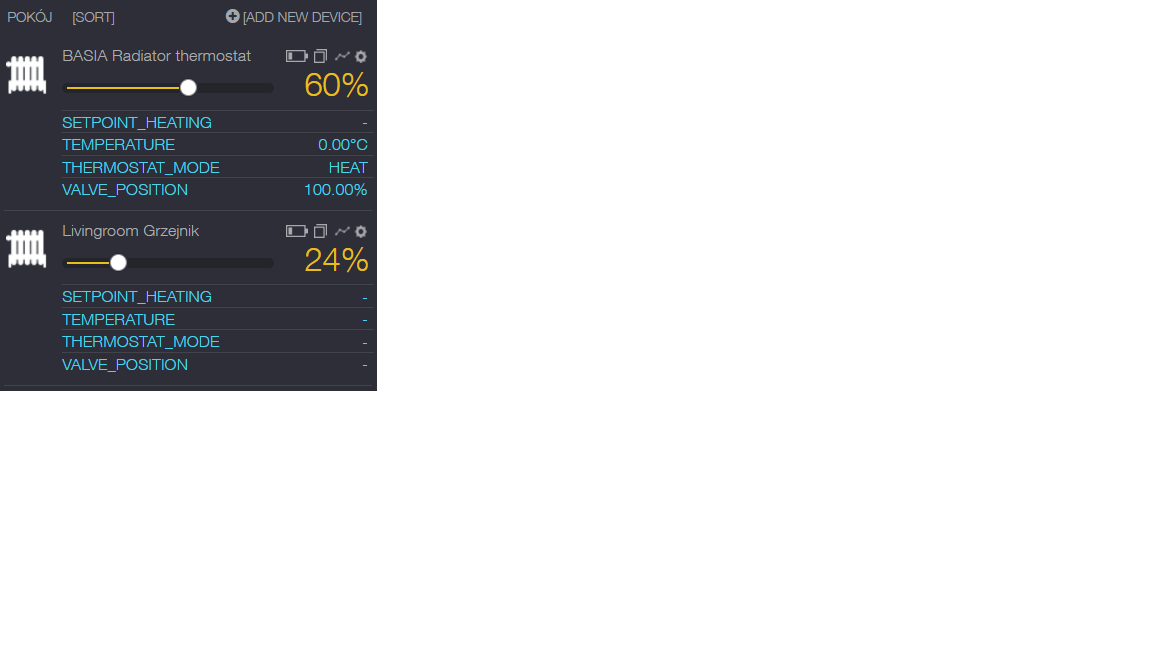

Hello, I have sever of these and just adding to Zipatile. Before used VERA EDGE and had a option to change temp by setting it with +/- buttons. Now in zipatile it is 0-100%. Do you know how to change that?
this is basic UI representation of the device. In order to control it as thermostat, you have to create Zipato Virtual Thermostat and add this device (or multiple devices) as heating input and thermometer in it. Afterwards, you will have regular heating set point commands, as well as weekly scheduler.

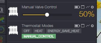

Update: the including was succesfull. In the attached pictures you can see how the comet shows op in the module- and devicemanager.
But.... the communication/response is weird. When i change the valveposition or the mode, sometimes it seems to work, but mostly the values jump back to the previous setting.
I get it... that's what Marko ment with "* Since it does not send unsolicited status updates, the actual current valve position will usually only be updated on the ui after two wakeup intervals "

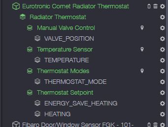

Now, can anyone help me out how to control Comets in terms of setting their required temperature rather then 0-100% valve. I had these installed on Vera before and it worked that way. Thanks.
Create a virtual thermostat and put the comet in heating-output and thermometer-input. Then you can set the heating-setpoint.

My Comet is inserted in the virtual device Cooling device as in HEATING OUTPUTS.
The temperature is detected by the sensor inside the ZipaLite as default.
Yet the temperature at COMET in SETPOINT_HEATING value is always 22 ° !!
