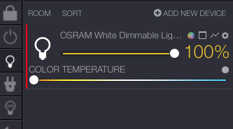

I have a development wall plug(http://www.develcoproducts.com/products/smart-plugs/smart-plug/) from a danish company called Develco, which I have added successfully, so no complains there.
Just yesterday, i bought 4 Osram Lightify GU 10 bulbs from the local hardware store (Bauhaus), extremely expensive if you ask me...8(
I bought those as a test, could i add them directly to my Zipabox Zigbee module, if not then i had read they should be able to be added through my Philips Hue 1.0 Bridge. And if all failed, I'v would have bought the Lightify Osram bridge.
Came home, mounted one bulb, set Zipabox into Zigbee inclusion mode - and voila, added perfectly to my Zipabox(After a refresh/sync with the servers, the devices showed up) (See attached pic! It's currently red, because the switch to the lights are off!).
