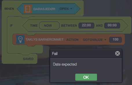

I´m trying to create a very simple rule, but get an error saying Fail: Date expected.
I want an alert of some kind, lets say a change of light from a lightbulb ,if my garage door is open after 10 PM.
My rule is this:
WHEN garagedoor = Open
IF TIME NOW BETWEEN 22:00 AND 06:00
<some lightbulb> ACTION GOTOVALUE = 100
Under My Home Rules, it´s also labeled "INVALID"
What am I doing wrong?
you must use a time select control from variables section, don't write time (i don't know why it is allowed)![]()

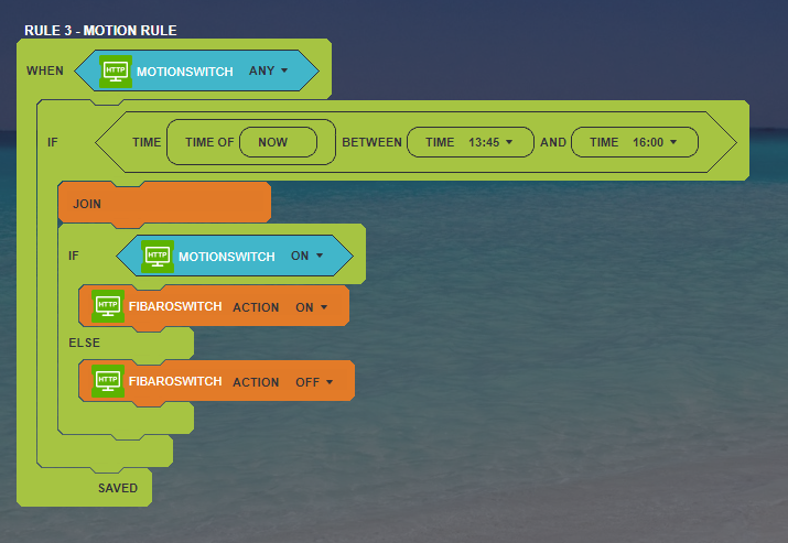

Hi, you should use time of (now) - rule example is attached.
Thank you both for your responses. In case anyone else drops in on this thread; don´t forget to set timezone in your Controller settings :) That was obviously one fault. In adition to that I changed to the the "time select"-controll as you said Martin. That did it. Thanks!
