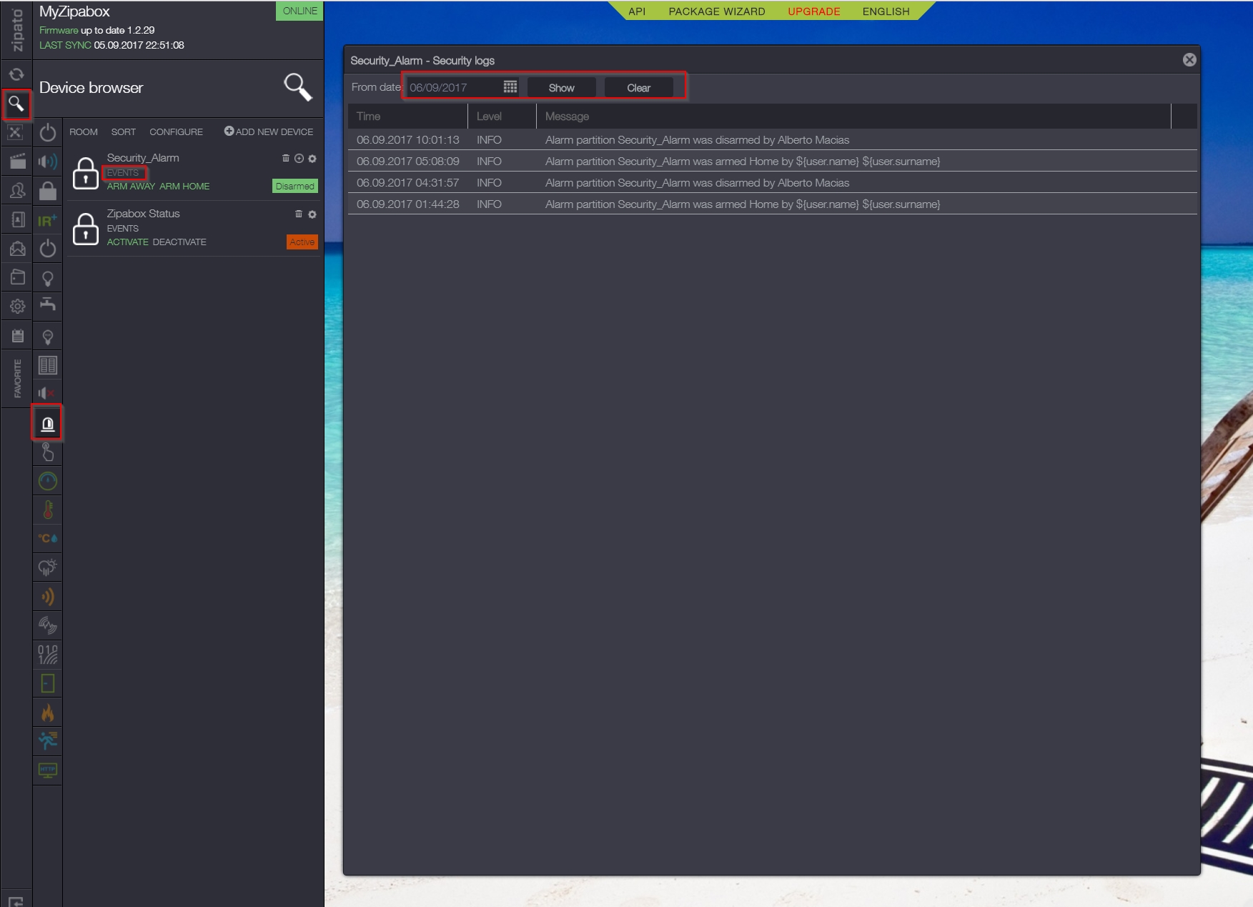

This seems like a weird behaviour for your Virtual Alarm. You can see "events" of the virtual alarm by going to device browser / alarms / and events on the desired partition, see attached. Also you can configure "reports" on the same virtual alarm by going to settings / reports and you can add yourself as email / push / sms (requires credits), emails are very descriptive and they show which zone triggered the alarm.
As I mentioned before this seems like a weird behaviour, did you configurated the lights and shutters as Siren? or through a rule to trigger when the alarm is Tripped? otherwise is not a standard behaviour on an event of smoke or flood, usually unless you change something in the alarm configuration these will only trigger their own device's alarms and siren (if any configured) or reports (if any configured).
