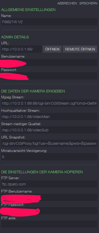

The IP 10.0.... is correct. You have to add your username and password in the fields. AND the ftp data have copied in the ftp section of the CAMERA!
Attached you see my configuration, which works. Took a long time to get it :-)
for mjpeg: http://10.0.0.1:88:88/cgi-bin/CGIStream.cgi?cmd=GetMJStream
Hope it will help.

I tried to setup all setting like your (that I already have tried, excluded for mjpeg link that I had empty) but not worked.
Knowing the for you are correct I tried to change the only thing could be "not correct": password, now work properly!
Incredible...it isn't the first time that some characters are always allowed. I my first password there was percent symbol (allowed for Foscam system) that seem not allowed for Zipato web interface system.
Thanks a lot for your help!
