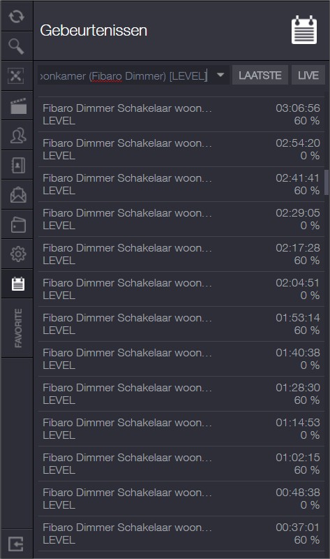

Since a while I have several Fibaro dimmers (type 2), that on occaision live their own lives.
For example, since yesterday evening, one is turning the light it's connected to on and off at about 12 min. intervals.

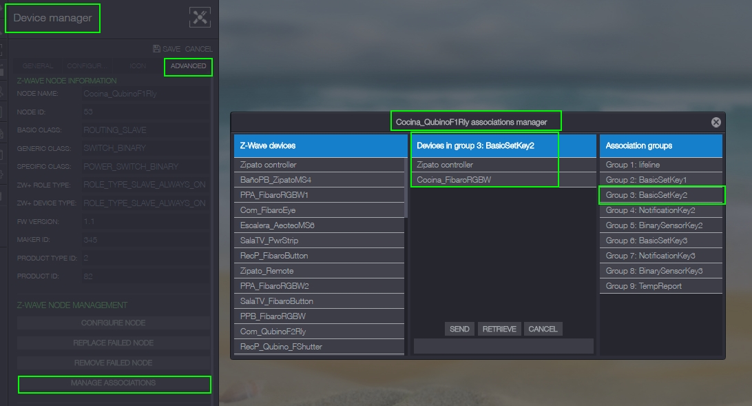

Did you ever made direct associations between this device and another?
Also,

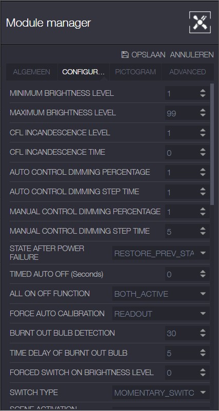

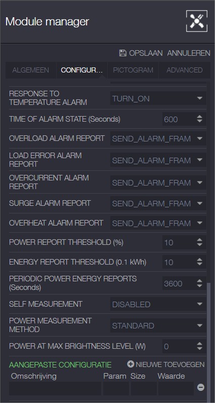

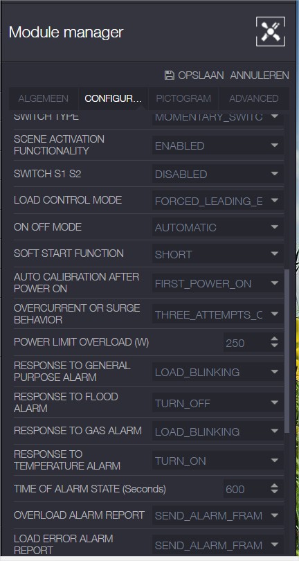

I hope I've attached what you're asking for. Pls. bare with me I'm fairly new to this.
Attached is a screenshot of the events (is there a separate log file?)
As for the Device config those are added as screenshots as well (is there an easier way?) as Module config 123
@Alberto
I'm not entirely sure what you mean by "direct associations", so probably no. But appreciate if you can explain so I'd be able to make sure.

Don't see anything wrong.
But try the disable the alarm broadcast. ps: Click on the item to open de send menu.
Robin, under the Device manager, tab Advance, and look on the line Z-Wave node mangament were you can see the associtation button.
