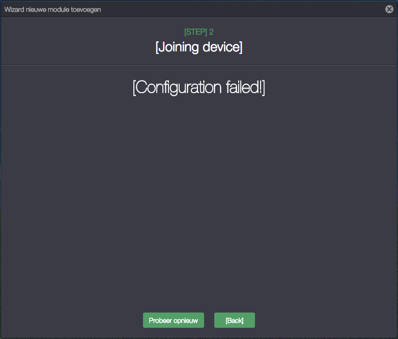

I did a downgrade to the regular release and nog I get a "Configuration Failed".
Is it possible the device (rather new model) is not being recognized as the reason for this failure?

I've just install 2 new FGD212.
I've got the same problem with the inclusion process.now It works you need to place your module close to your box (1m or 2m).
The inclusion process was successfull, but the module is not really recognized by the box.

Thanks all, I indeed got the Dimmer included after placing the Zipbox VERY CLOSE :-s But as Gizmodu72 states there is not a lot usable until full support is added. Hope this makes it in the system rather soon since I have 7 of those modules.
