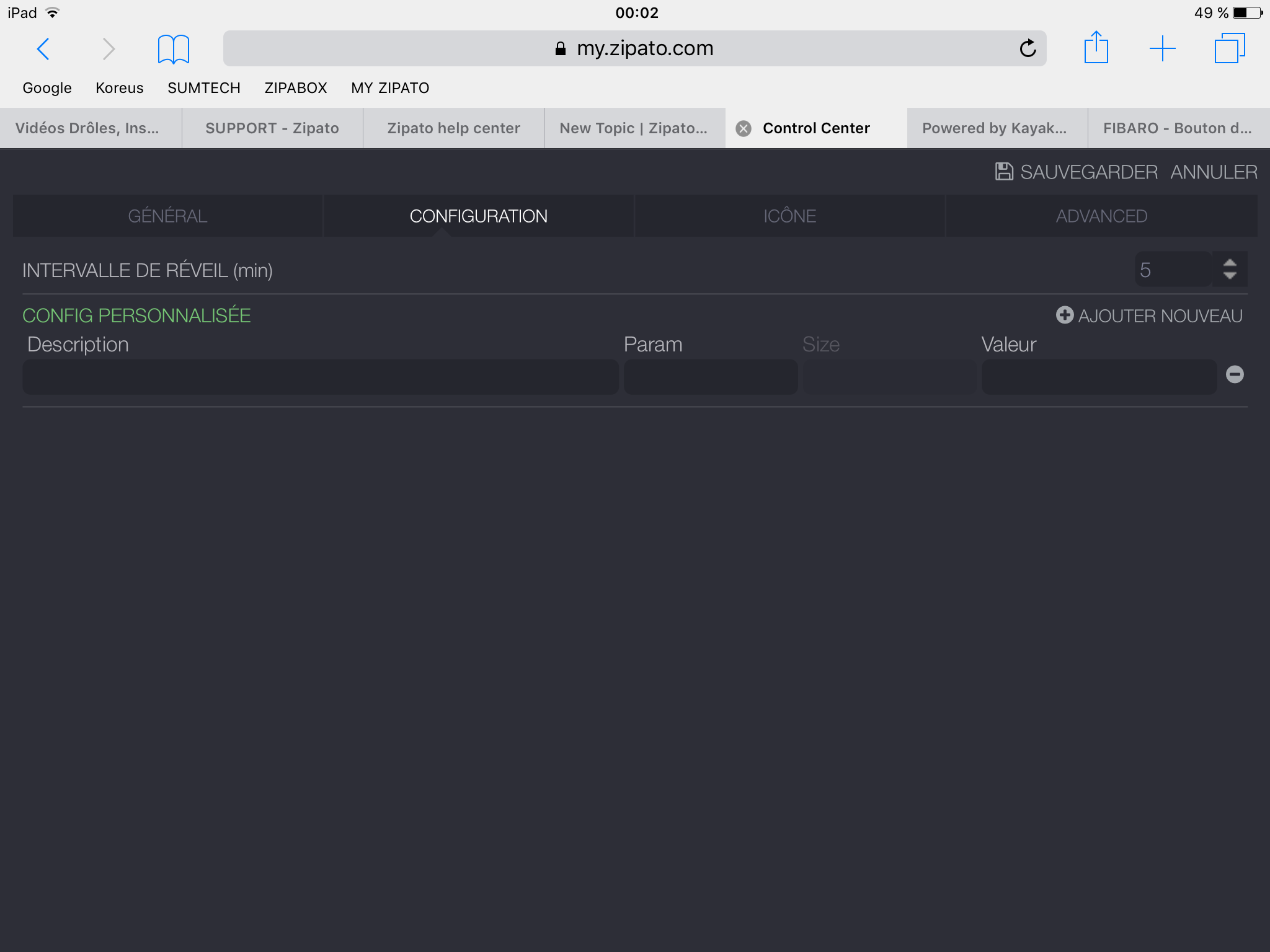

I have a button fibaro FGBS-101. I can add it to my zipabox but I can not configurate it. There is nothing in the configuration panel. Could you help me.

You could manually add the parameters to it, just refer to the manual to find out which parameter, size and value you should configure. Do you have endpoints in the configuration and does it show as actuator on the rule creator devices? I would also open a ticket to zipato support so they are aware of this.

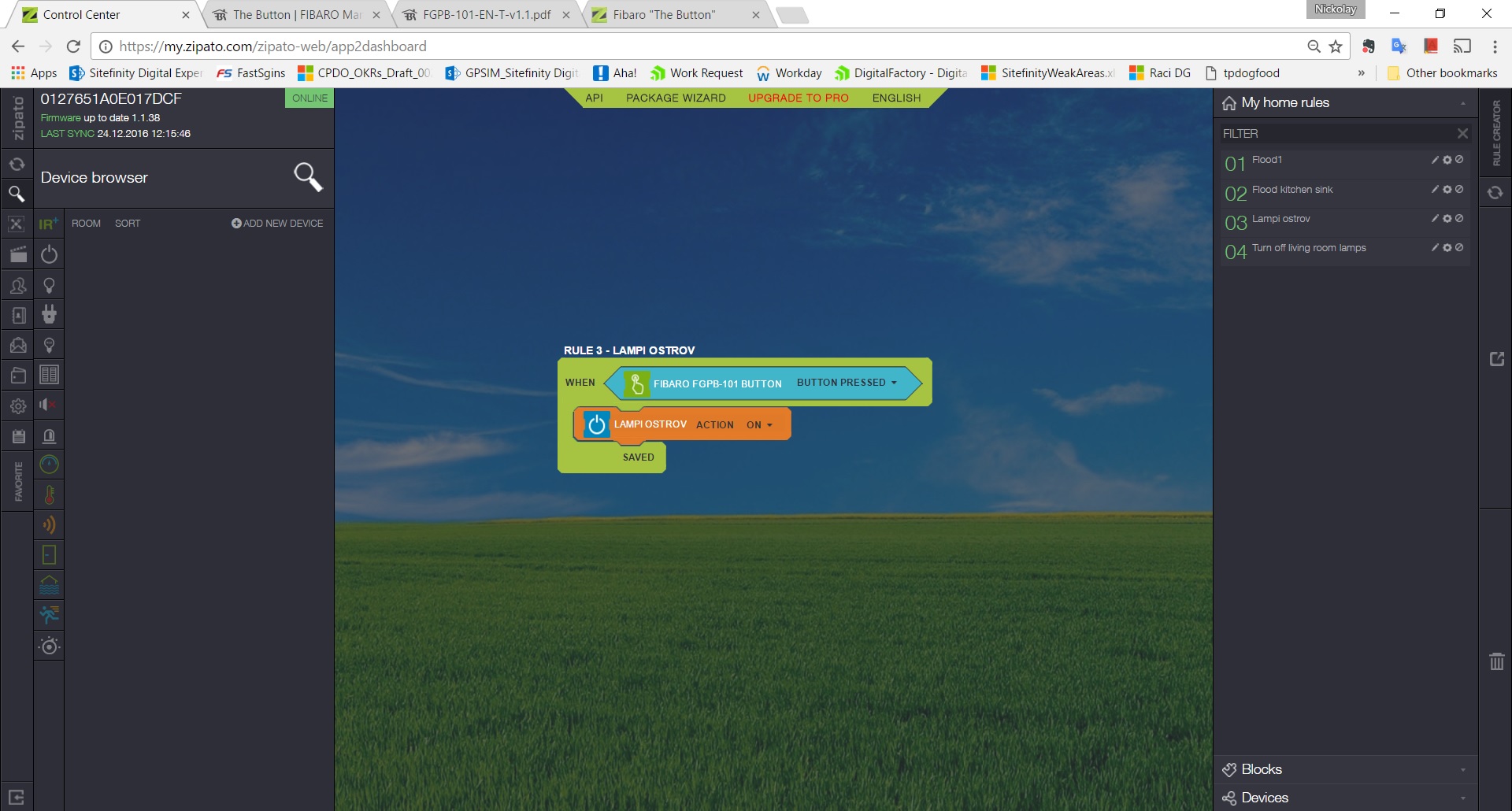

Guys is this the rule one should use. I am not getting any effect after pressing the button. The button is included and the range is right next to the controller?
I am on latest firmware....
