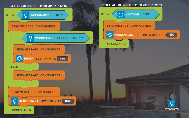

I can't seem to start an rule using action events. I have several Fibaro FGD211 and Fibaro FGS221 devices when I create a rule to start at ANY action event, nothing is happening.
1. Is there a function to see which events a device have been triggered by a device. In the event log (gebeurtenissen) I'm only able to see the state of an FGS221 or the Intensity of the FGD211.
2. How do I trigger a rule with these action events?
try using the "action" block instead of the "set" block. Otherwise I dont see why you messages arent being sent. Looks ok to me.
