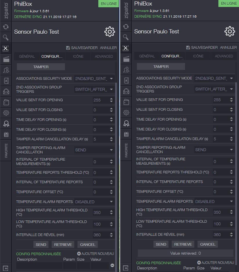

Fibaro FGDW-002 (Door / Window Sensor) : Wake up interval remains at 360
The FGDW002 wakeup time interval remains set to 360 in the Control Panel while interrogating the module the value returned is 0 (function retrieve)
to change configuration parameter, you should firstly press Send button (click on parameter title to open Menu with Send/ Retrieve/ Cancel buttons) and when the confirmation message is received, you can check a new value by pressing Retrieve button.
