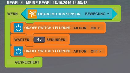

            Dear Friends,
I am a Starter and struggeling with Motion detection of Fibaro. The rule I created does not work. Can anyone tell how to make it right.

Stephan,
Can you please explain what you want to achieve so I can tell you how to change the rule? It looks like it would work but I use a different approach, of course it depends on your purpose.

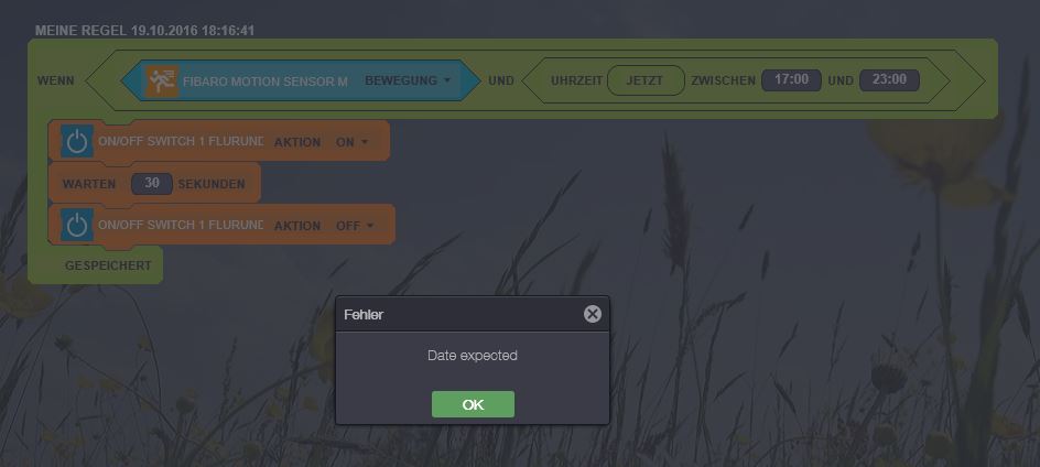

Now I do have a further question: How can I manage to have certain times when the light goes on
I tried it with this rule, but got the message: date expected?!?
Can anyone help or ost a rule that only works between defined times during a day

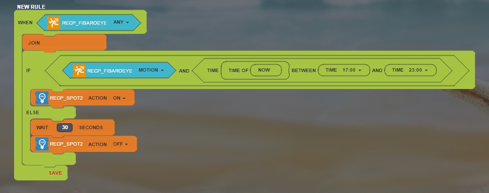

Stephan,
No problem. With the rule you have you will turn OFF the light regardless if there is still motion in the room after 30 seconds, not sure if that is your real intent or not. See attached rule, this rule will keep the light ON 'until it stops detecting movement plus a 30 second delay. Also It will work only during certain times of the day. Any other question please let me know.
Stephan,
