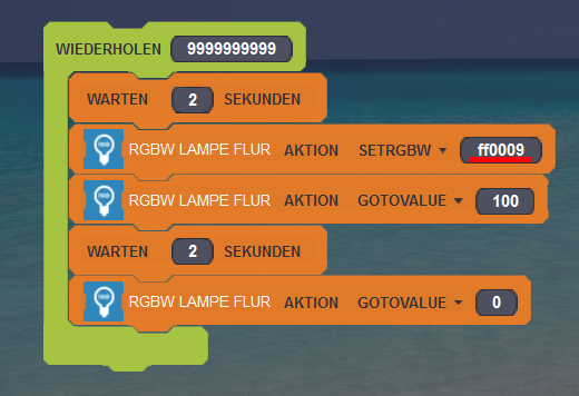

can we use rgbw alarm mode in zipabox ?
need to have a blinkin rgb when alarm activated
I don´t know about the limits of the repeat rule but as a quick workaround I´d try it as shown in the picture below.

should be good, we did this for a show. When the alarm was armed the Fibaro RGBW and a Zpiato RGBW bulb turned red and flashed twice. When it was disarmed it flashed green for 5 seconds. This was about 6 months ago but should still work.
