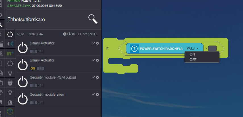

I just add the FGS-223 and inclusion went ok and I can control the switches. The only problem is that it shows up as 2 binary switches and there are no parameters available.
I deleted the module again and I will wait until the device is properly supported.
Same problem here, FGS-213 was added correctly, but I can't see any parameter and the device is shown as a binary switch.
It seems that this device is not fully supported at the moment.
