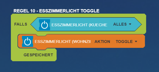

Reason is, that I miss one light switch in my kitchen to turn on the light in the dinning room. Therefore I installed the Fibaro which will trigger the other Fibaro switch to turn on/off the light.
The rule is attached and works fine.

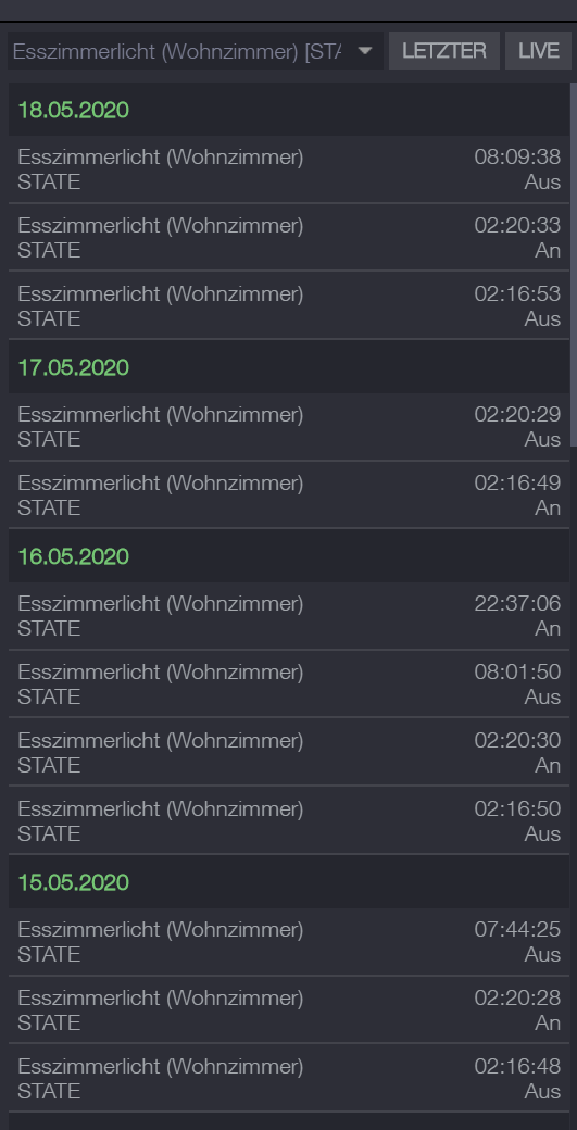

But, nearly every night, the light turn on automatically at around 2:20. See attached event log.
There is no rule which is responsible for this. What happens at this time?

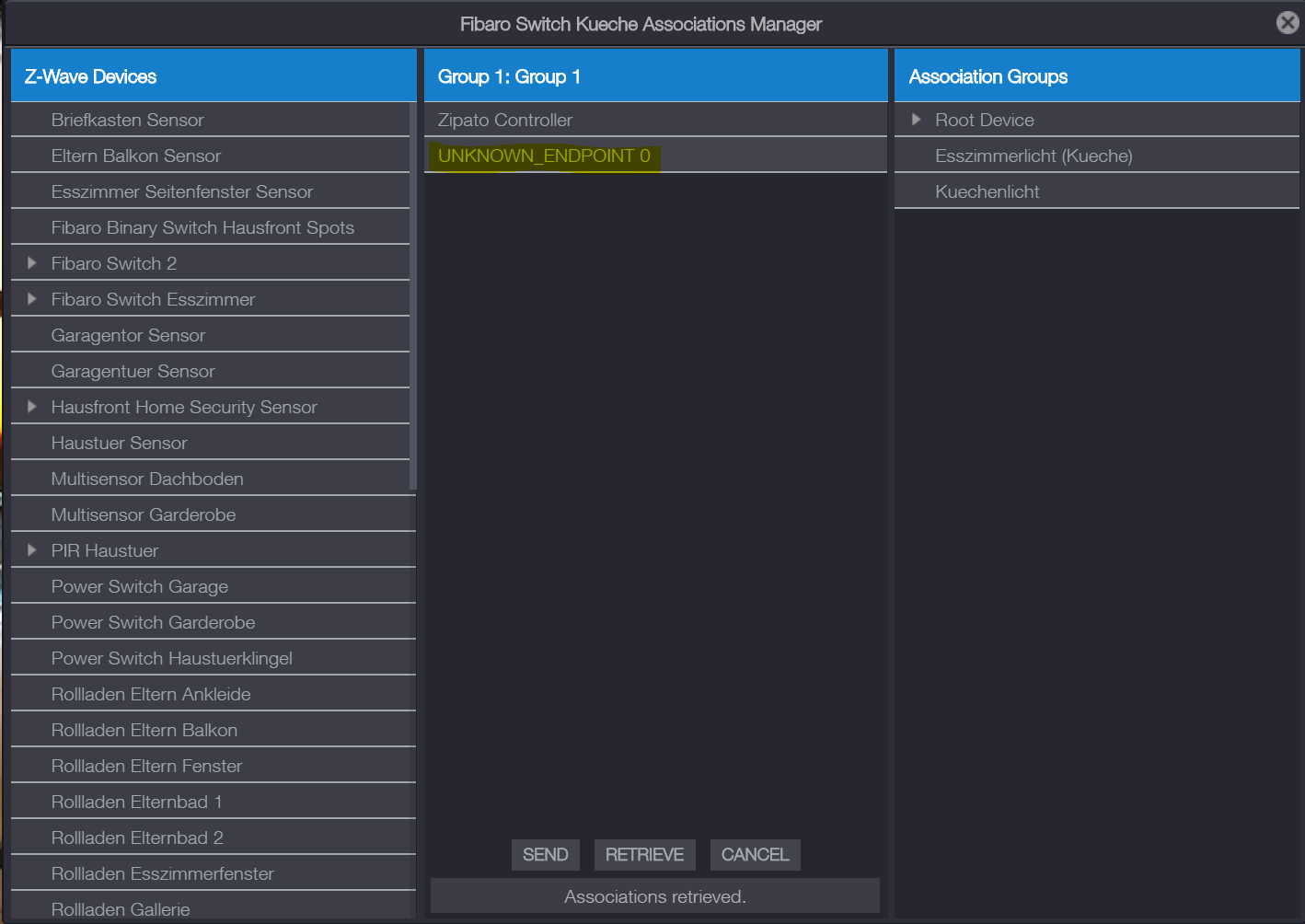

But I think you are right that it has something to do with the associations of the device. There is one association which I can´t remove. When I remove it, click on send and after that on receive, it´s there again.
How can I remove it?

the solution is to delete association with right click on the associated device and select "Remove from group". After that click Send button (wake up is required for battery devices) and wait for the confrimation message "Associations sent" . By clicking Retrieve button check its status - deleted association should not be shown.

I did this of course, but after clicking receveive the UNKNOWN DEVICE 0 pops up again and again.

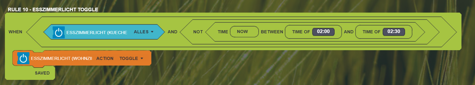

I changed now the rule to the attached one, so that the switch will not turn on/off the light between 02:00 and 02:30.
I hope that this is a good workaround.
