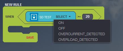

now the Wall Plug is possible to integrate - thanks. But i can't use consumption in rules .... can you check it please..

You Need to use the meter puzzle not the sensor puzzle. This also means you will insert the meter puzzle into an operator (like =)

Hi Attila,
it's the same ... i have checked it before ...

I wonder if this is a not correct descriptor for this device. When adding for example a Zipato switch (of Fibaro RGBW controller) I have consumption option.

Perhaps not the correct device is used in this rule. Some devices have various sub-device from the Zwave root device. See the subdevice that is metering and open options for it. There select "Include in Rule Creator".
See if this helps.

Please rejoin your units, it should be fine now.
Yes - now it's in the rule creator - fine...

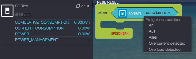

My plug doesnt show current consumption, only cumulative.
Fibaro FGWPE/F-102 Wall Plug, firmware 3.2

If you go into device manager and open your wall plug, in the submenu is power setting for current consumption.

This is how it looks like.

Hmm, interesting. Try to open up the root device and click on:
- re-apply descriptors for the device (on bottom of the 1st tab)
- configure device (on last tab)
Save, synch and refresh
Then turn on a light or something attached to the plug.
Any change?

Nope, still not showing current consumption.

I have same problem- But you can use power and set that as meter.

Using "power" as meter, you can see the current consumtion, problem is that you can't set any rules based on power
