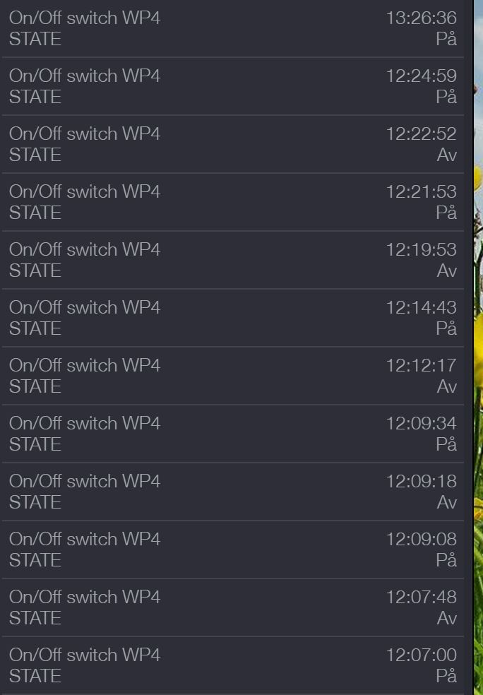

It's not inluded in any rule or scene, always on has been enabled.

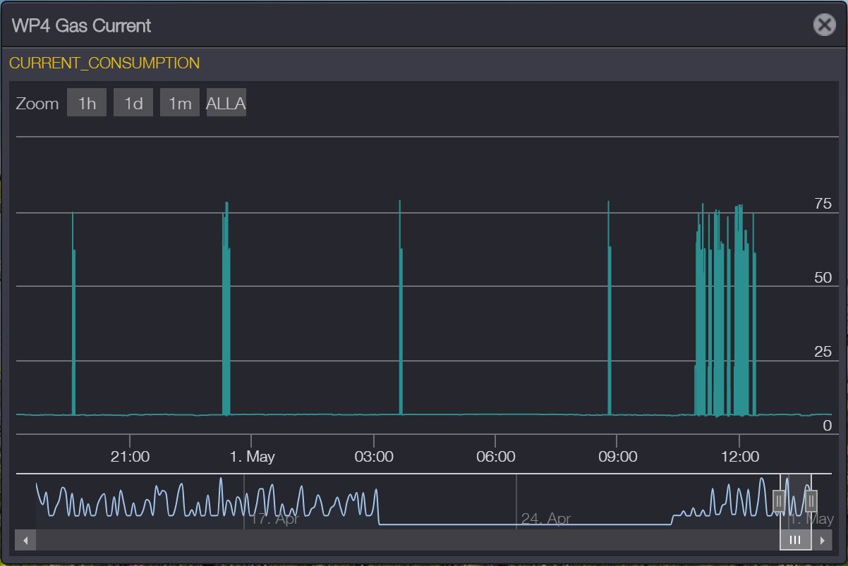

The energy consumption never reports 0w but lays still on 6,5 watt which is the consumption of the connected home appliance in stand by mode.

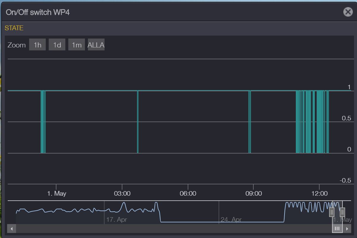

The wall plug seems to report it's turning off when the connected device is started, Then it reports itself as on shortly after. I am not there to see if it actually shuts on and off or if it just sends the changed status.
Anyone have an Idea what's happening here?
(Another Wallplug just a couple of meters away are steady not living its own life)
