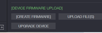

Is Firmware upgrade of ZWave devices available yet?
3
It seems that it has been integrated in the meantime:
/8cd29a973edd6b56b178fea120ab9c54
4
I assume that's on V2?
