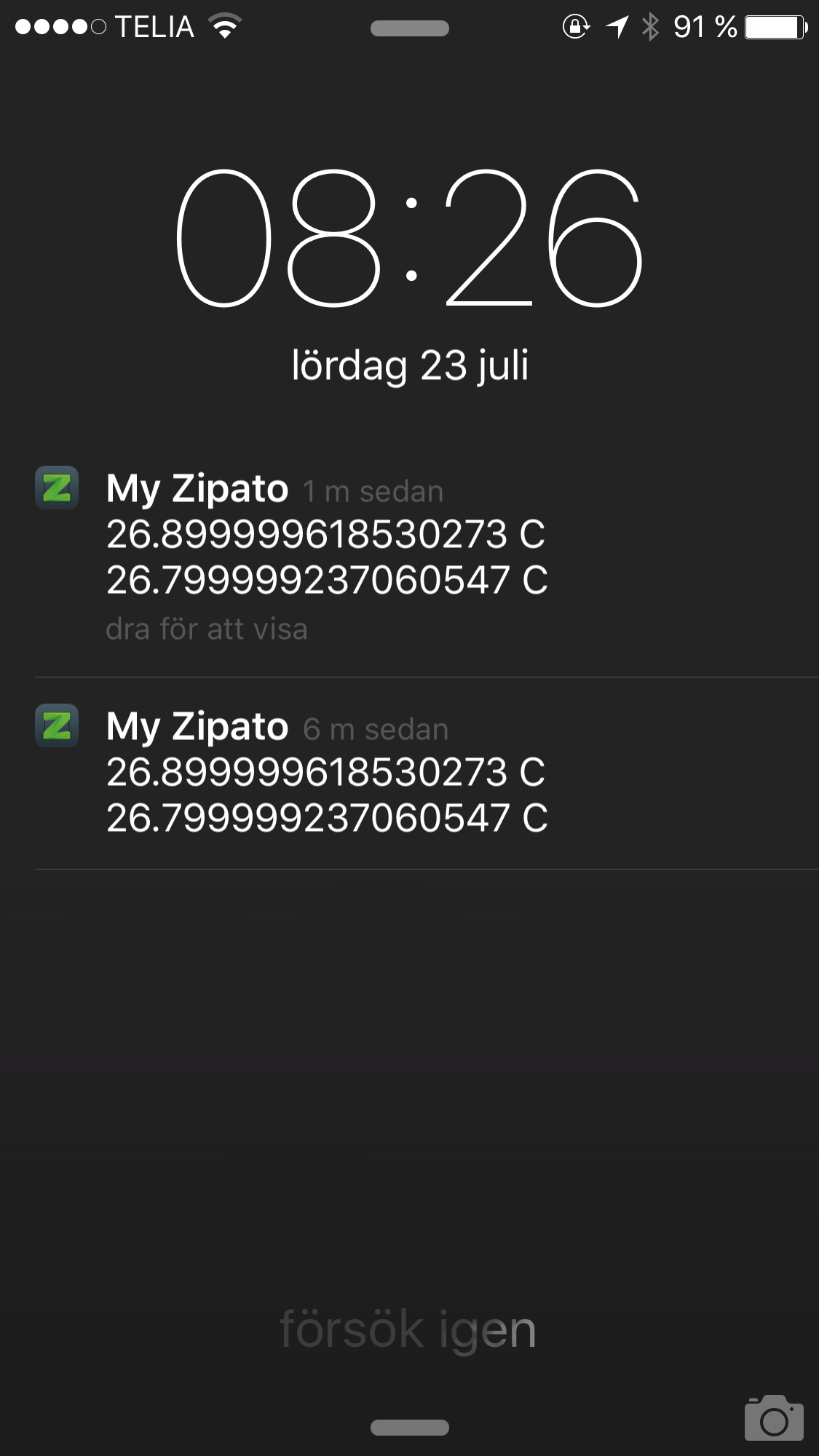

Still I like to se some numbers formatting function to prevent the messages to look like the attached.

@Torbjorn,
Zipato is working on the Decimal issue, see message above, where Pero wrote
"Update: Our team also trying to resolve an issue with decimals numbers
and case when a variable is not filled with a value but is still sent
through the message Puzzle."
Thanks a lot for this update and confirmation !
Br
Torbjorn
