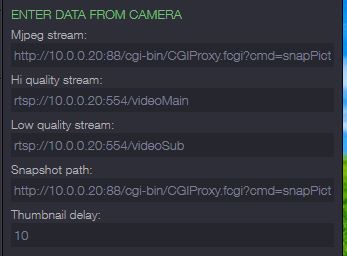

im using a foscam C1 which is working inside Zipato RTSP, MJPEG and Snapshot URL (which is the same as the MJPEG Url).
But the problem is that the preview picture is sometimes 1-3 days old, and also when i hit "Make Snapshot" the snapshot isnt saved to zipato (sometimes a little bit later it shows up but mostly there is nothing).
Also when i make a rule that zipato should send an snapshot on alarm, the snapshot is not from the actual time (its the last that i see under snapshots (in the smartphone app)).
MJPEG/RTSP streams are working and when i click on "snapshot image" i see the actual snapshot (time/date is in the picture from the cam)

During detection on our system we are considering your Foscam C1 cameras to have two levels of h.264 stream and snapshot option without MJPEG because that is their factory default. Foscam C1 cameras can not have MJPEG and two h.264 streams at the same time according to their support page. That is why there is same url for your MJPEG stream like it is for snapshot.
http://foscam.us/forum/how-to-fetch-snapshots-and-mjpeg-stream-on-hd-cameras-t4328.html#p20263
Older C1 can not have MJPEG at all again according to their support because "What was said by the foscam tech support team is that it does not support the MJPEG stream due to the chipset that is used for the camera.".

But what are the buttons under the camera are for (or the thumbnail delay option under "Edit") ?
"Refresh"? *)
"Take Snapshot" is working and showing me an actual snapshot from the cam
"Open Stream" is also working
But in the App when i hit "make snapshot" this isnt working (or just say sometimes)
*) Ok found out that i have to close and reopen the app / also this is working with the webpage (normal behaviour?)
