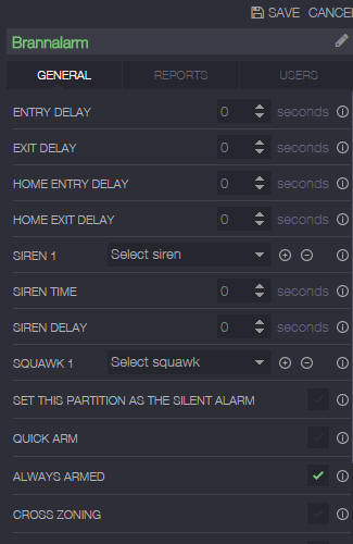

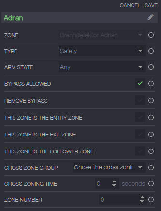

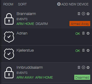

I'm trying to include my fire detectors into a alarm partition but i'm guessing i do not understand how the alarm partitions work.
I have added one partition and two fire detectors into the partition, the partition is set to always armed and safety.
When i trigger the fire detector, the device it self shows smoke detected but the partition is not triggered. This does not show in the events of the partition either... Is there anyone that can advise me on how to actually do this ??
I have attached the relevant settings.

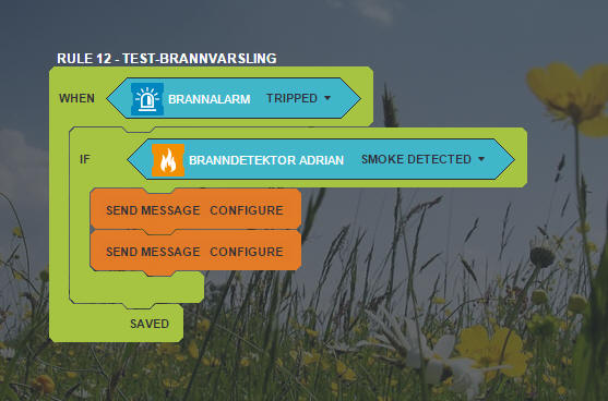

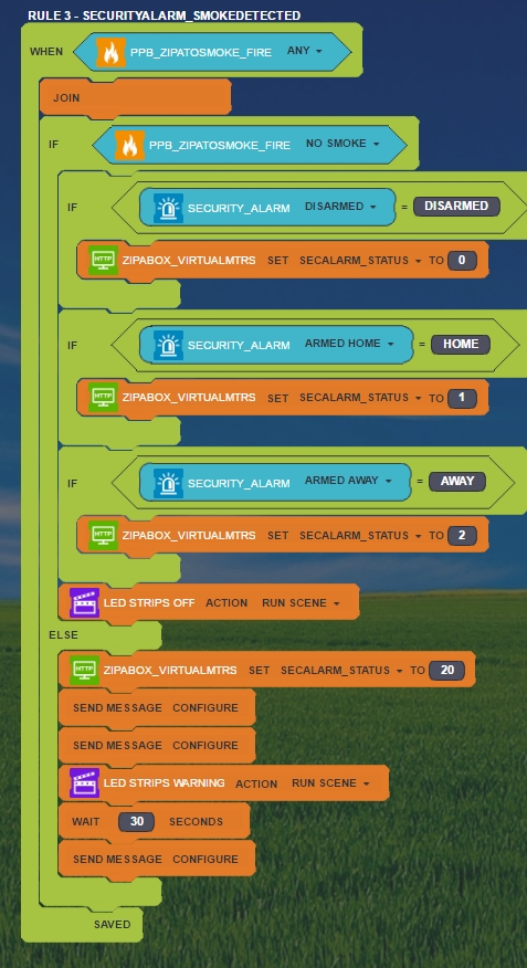

Mine was working before... don't know at what point it stopped. Yesterday while cooking my wife triggered the some detector and its built in alarm went off, I didn't receive automated notifications (email), but since installation I have created the attached rule with did work and sent SMS, push notification and triggered the programed scene. Perhaps there is a issue with the firmware upgrade and the smoke detectors, I'm sure they used to work since I tested it and received the email. I created the rules because I wanted something very specific for this matter.
I will open a ticket though, alarm wasn't fired, also events are not showing up ( I noticed some events now don't show up anymore, when you configure zones as cross-zoning you used to be able to see which zone started the cross-zoning timer and which one triggered the alarm).
