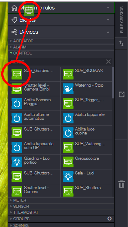

In general, it needs to be easier to maintain the system. For example: why can't you find out where a virtual switch is being used? They're not included in searches when you write in the "Find" box. Or which rules a device is used in? Zipato often casually suggests deleting a re-adding a device to fix a problem, but this is very time-consuming when you can't quickly check where the device is being used.
To achieve this there's a nice functionality in the web UI. From the right rules bar, if you drag a device to the header "My Home Rules" then the rules are filtered showing only the ones that use that device (see screenshot).
