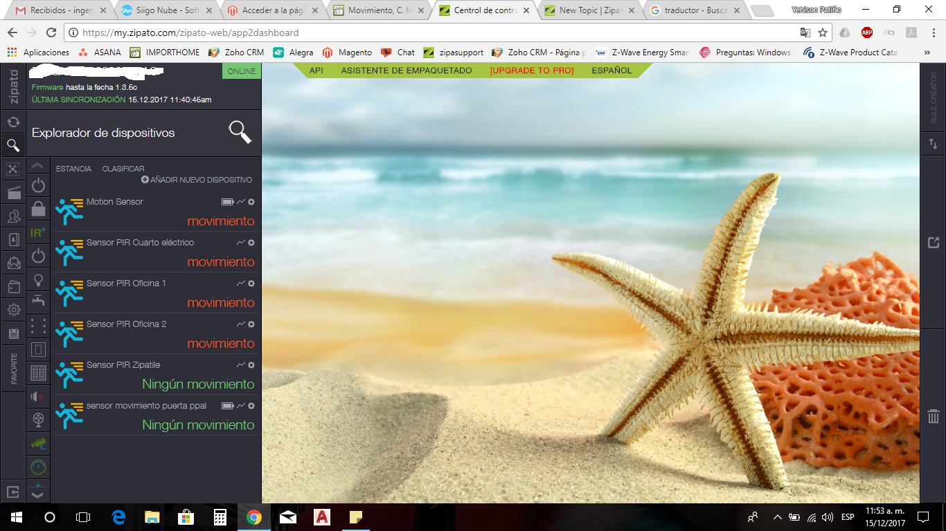

hiI have four motion sensors go control WAPIRZ-1 and when I add them to my zipatile they add supposedly fine but then they change state to "movement" and the battery status is not displayed.
I noticed that when I enter the room the red light turns on indicating that I detect movement but when I go out on the zipatile and my PC does not change the state they are always detecting movement as seen in the image.
I've tried re-installing it, waking it up, adding it near the controller and using the z-wave network topology update tool and none of that worked.
I have added other sensors and they work well.
Anyone having the same problem?
How can I solve it?

Raise a ticket. I never heard of these sensors, so nor sure if they are fully supported via a template.
This sensor is from the brand Go Control before the linear call of the United States and I opened a ticket but they have not given me an answer.
