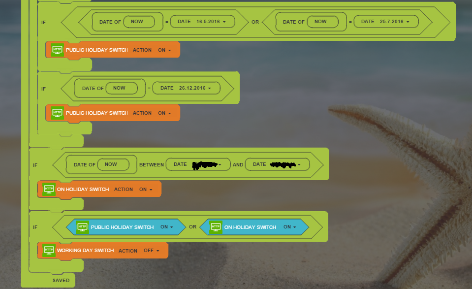

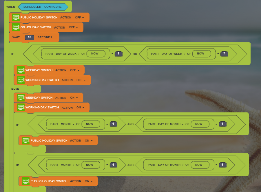

@Andreas: Sure. I've attached a partial snapshot of my rule (note: the rule is so long that it appears to have hit a Zipabox bug. If I try to add another date to it, the change is never saved. I advise splitting the rule into 2 parts).
First I initialise the variables and then wait 10 seconds. This is to avoid another Zipabox bug, one that prevents 2 changes in rapid succession to the same variable from being applied. I check the day of the week and set the appropriate switches for that. I then test the standard public holiday dates, the ones that never change, by just checking the day and month. These will sometimes fall on a weekend, but since I don't work on a weekend I don't need to take that into account. Others may need to. I then program in my holiday (vacation) dates for the year at the end. I need to alter these each year. I wanted to add two sets of dates, but couldn't because of the aforementioned bug. I then turn off the "working day" switch if it's a holiday or vacation.
Oh, and I run the rule just past midnight every day.
When I have time I will split the rule into two, one for public holidays and the other for vacations, running one shortly after the other.
