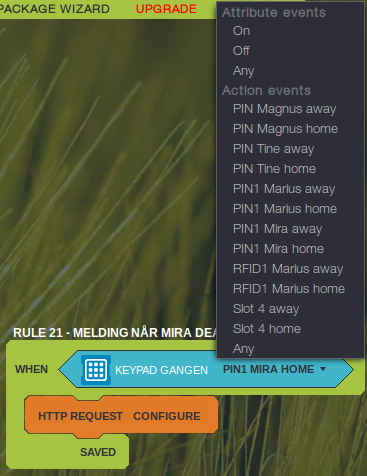

i can include my mini keypad and learn raid and pin for a user.
in my rule creator i can only see and use <user_pin> trigger, but in the event log i see something different
How do i configure the rest so i can trigger a rule when a user arm og disarm the system ?

It has been a while since I experimented with this, but I can see in my Keypad puzzle that all PINs and RFID-tags can be selected.
In my Keypad, I have one slot with event named "PIN Marius" and another slot with event name "RFID Marius". Both two are selectable in the event puzzle. I'm not sure if this answers your question, but see attached rule example, maybe it helps
