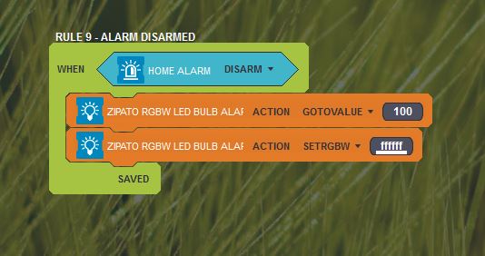

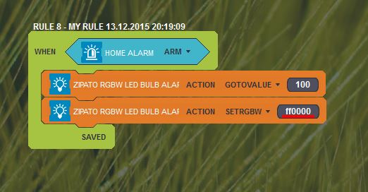

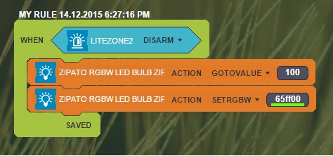

I was able to create two different rules to get things working, but when the alarm is armed and my wife needs to do laundry the room is red. I guess I would have to put a sensor on the other door leading to the laundry room from the house, but I'm not sure how to handle that when you're leaving for work in the morning and forget that you armed the alarm the night before.
